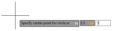

  1. Start the CIRCLE command. Find

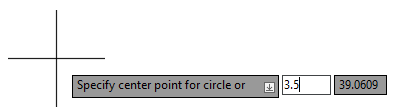

    AutoCAD prompts you for a coordinate value that represents the center point of the circle. Three tooltips are displayed with focus set to the second tooltip which represents the X coordinate value.
  1. In the second tooltip, type 3.5 followed by a comma.
    The focus moves to the third tooltip which represents the Y coordinate value.
  1. In the third tooltip, type 5 and press Enter.
    The absolute coordinate value of 3.5,5 is used as the center point of the circle and the next prompt of the CIRCLE command is displayed in the Dynamic Input tooltip.

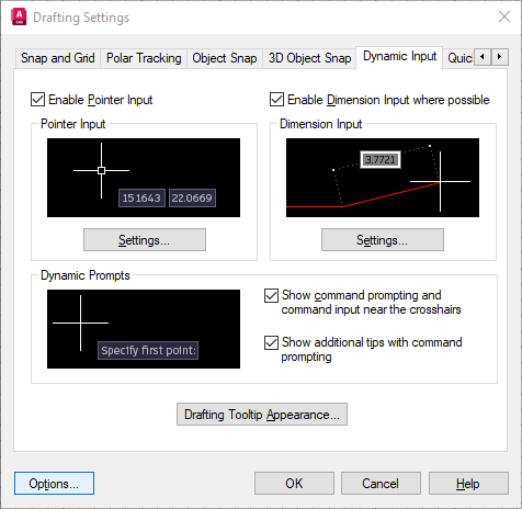

The settings for Dynamic Input can be found on the Dynamic Input tab of the Drafting Settings dialog box (DSETTINGS command). You can display the Dynamic Input tab of the Drafting Settings dialog box, by doing one of the following:
  • Right-click over the Dynamic Input button on the status bar and choose Dynamic Input Settings.
  • At the Command prompt, enter dsettings. In the Drafting Settings dialog box, click the Dynamic Input tab.
The following provides an overview of the settings on the Dynamic Input tab of the Drafting Settings dialog box:
  • Pointer Input - Controls the behavior of coordinate entry for the second or next point, and when the coordinates are to be shown.
  • Dimension Input - Controls the behavior of dimension input tooltips used to request length, angular, and radius values.
  • Dynamic Prompts - Controls the display of prompt and input tooltips near the crosshairs.
  • Drafting Tooltip Appearance - Controls the appearance of the input tooltips; color, size, and transparency.

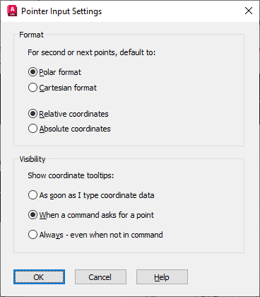

The settings under Pointer Input impact how you enter coordinate values while Dynamic Input is active. Click Settings to open the Pointer Input Settings dialog box.
In the Pointer Input Settings dialog box, you can control the format in which the second or next point needs to be entered while using Dynamic Input. The default format settings are: Polar Format and Relative Coordinates. Setting it to Relative coordinates saves you from having to enter the @ symbol before entering the second or next coordinate value for a command.
The Visibility setting controls when the Dynamic Input tooltips are displayed. By default, they are only displayed when a command is active.
Tips for the Display of Dynamic Input Tooltips
  • If you set the Visibility setting to always display Dynamic Input tooltips, the current position of the crosshairs will be displayed in the Dynamic Input tooltips when a command isn’t active.
  • Do you find the text to be a bit too small in the Dynamic Tooltips? If so, you can increase the size of the text by opening the Drafting Settings dialog box (DSETTINGS command), clicking on the Dynamic Input tab, and then clicking Drafting Tooltip Appearance. In the Tooltip Appearance dialog box, slide the Size slider to the right to increase the tooltip’s text size. Click OK twice to apply the changes.
