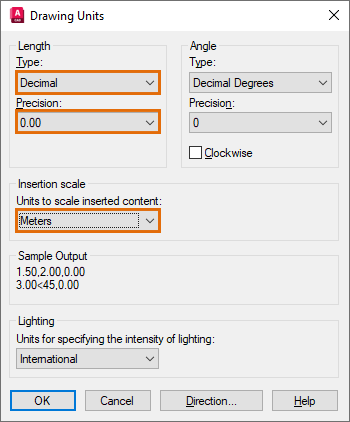

  2. Define the drawing units by clicking the Application button Drawing UtilitiesUnits. Find
  3. In the Drawing Units dialog box, specify the following and click OK.
    Measurements in the current drawing are displayed in decimal format and one drawing unit represents one meter.

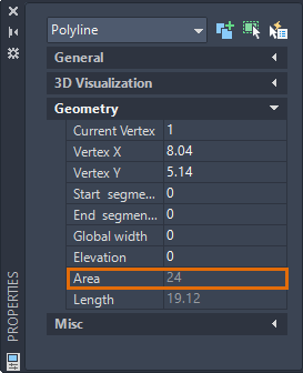

  1. If the Properties palette is not displayed, select any object. For example, the perimeter of RM 1 as shown.
  2. Right-click and choose Properties.
    Properties of the selected object, including the area, are displayed.
    Note: Unlike individual lines, polylines are considered closed objects and always have a calculated area.

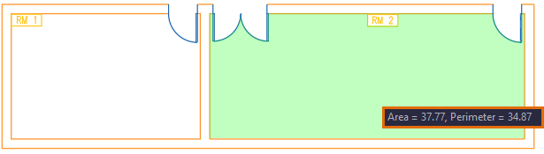

Another way to display the perimeter and area is using the Quick option of the MEASUREGEOM command. Let's recalculate the area with Quick Measure.
  1. On the ribbon, click Home tabUtilities panelMeasure drop-downQuick.
    You can see calculated values as you move your mouse over and between objects.
  2. Hover to a space inside the perimeter of RM2.
  3. Click when the sides of the perimeter are highlighted.
    Note: The Quick option is designed to dynamically display the calculated area of an enclosed object. Notice that the defined area, highlighted in green, excludes the open spaces. Shift+click to specify multiple enclosed areas to calculate.

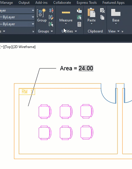

Let's insert some labels that display the area of the meeting rooms. While the AREA or MEASUREGEOM commands or Properties palette show the room area, these don't create a label in your drawing. We'll use multileader objects (MLEADER) and fields to display the area. For information and tips on using MLEADER, see Have You Tried: Multileaders for Labels and Callouts.
  1. Click the Annotate tab and locate the Leaders panel. Click the Multileader tool.
  2. Click anywhere inside the perimeter to specify the arrowhead location and then click a location for the leader landing.
  3. Type your text content (for example, "Area=").

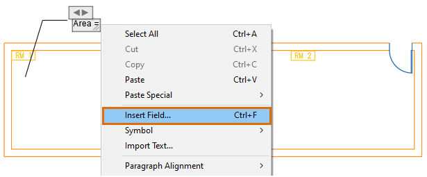

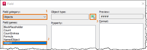

  4. Place the cursor where you want the field text to appear. Right-click and choose Insert Field.
    Tip: Press Ctrl+F if the Insert Field option is not visible in the shortcut menu.
  5. In the Field dialog box, specify the options in order as indicated.
    The Field dialog box closes temporarily.

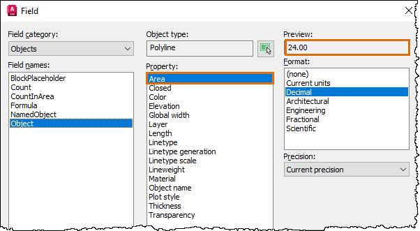

  6. In the drawing window, select the polyline that defines the perimeter of RM 1. The Field dialog box redisplays.
  7. The available properties for the selected object are displayed. Under Property, select Area.
    A preview of the calculated value of the selected property is also displayed.
  8. Click OK.
    The area for the selected room is displayed in the text of the multileader object.
  9. On the Text Editor ribbon contextual tabClose panel, click Close Text Editor. Alternatively, click in the drawing outside the in-place text editor.

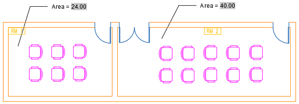

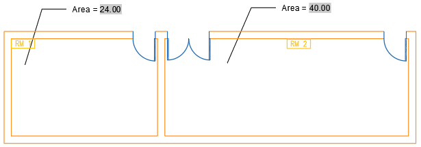

  10. Repeat the steps to create a label for the area of RM 2.
    The perimeter of RM 2 is outlined with an open polyline. When prompted to select the object in the Field dialog box, click the polyline that makes the bottom and sides of the room. The top line isn't a closed polyline for the room. A good practice is to check the preview of the calculated value in the Field dialog box.
    Tip: The data in the field doesn't update automatically. The FIELDEVAL system variable controls when fields are recalculated. If set to the default value, a save or a REGEN will update the field. Alternatively, double-click the text of the multileader object (where the field is inserted). Right-click and choose Update Field.
Let's say the county's new guideline allows one person per four square meters (m2) of floor space. We can identify the maximum number of occupants in the meeting at any given time by dividing the room area by 4m2.
Meeting Room Area (m2) Maximum Occupants
RM 1 24.00 6
RM 2 40.00 10
