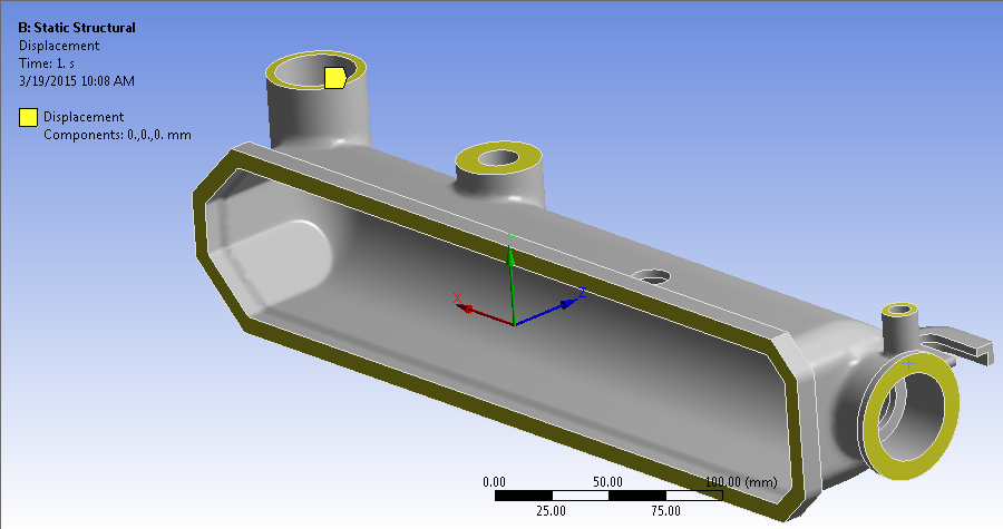

Apply boundary conditions that constrain the tank during the pressure loading.
  1. Select Static Structural from the model tree.
  2. Click Supports > Displacement and select the five surfaces of the tank as shown below.
  3. Click Apply to confirm the geometry selection.
  4. Enter 0 for the X, Y, and Z components of displacement.
apply bcs
