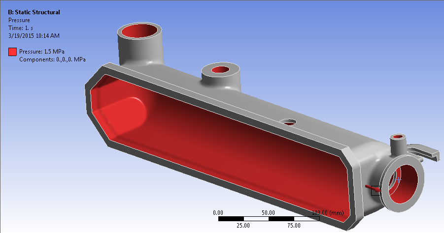

Share Email Facebook Twitter LinkedIn Define the LoadVideo Player is loading.PlayPlayMuteCurrent Time 0:00/Duration 0:00Loaded: 0%Progress: 0% Playback Rate2x1.5x1.25x1x, selected0.5x1xDescriptionsdescriptions off, selectedCaptionscaptions off, selectedChaptersAudio TrackFullscreenThis is a modal window. We will load the tank by applying an internal pressure of 1.50 MPa. Click Loads > Pressure and select the interior surfaces of the tank as shown below. Click Apply to confirm the geometry selection and enter a magnitude of 1.50 MPa. Parent page: Tutorial 2 - Analyze an Injection-Molded Radiator Tank
