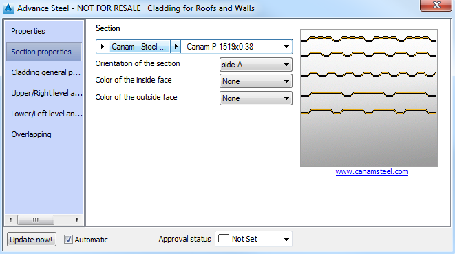

The Section Tab
Section class Selects the section type for the cladding profiles.
Section Selects the section size for the cladding profiles.
Orientation of the section Selects the cladding profile orientation. The section is rotated with 180º.

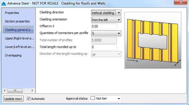

The Cladding General Properties Tab
Cladding direction Defines the cladding direction.
Cladding orientation Selects the cladding orientation. From the top or from the bottom (for a horizontal cladding) From the left or from the right (for a vertical cladding).
Offset in Z Moves the cladding in the Z direction.
Quantities of connectors per profile Select the quantity for 1 profile for 1 support beam. Advance Steel calculates the total quantity by multiplying this value by the number of cladding profiles and the number of support beams for the cladding area.

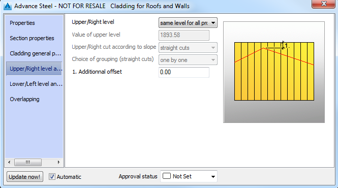

The Level and Offset Tabs - Upper / Right and Lower / Left
On these tabs, you can set the cladding shape at the upper or lower levels.
Examples:
Upper level Same level for all profiles All the cladding profiles are aligned at the same level, according to the slope.
Upper cut according to slope The cladding profiles can be cut straight or along the slope.
Choice of grouping (only for straight cuts) Select the number of profiles to be cut straight.
1. Additional offset The cladding profiles overlap the area. The offset can be positive, negative or equal to zero.
Total length rounded up to Displays the calculated length + the "additional offset" rounded to a total length " rounded up" to the next value.

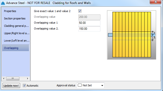

The Overlapping Tab
If the cladding profiles overlap, the overlapping can be set by one or two values. The overlapping values can be positive, negative or equal to zero.
