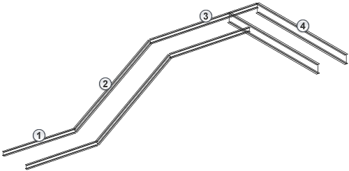

    Tip: Select multiple beams one by one. Generally, it is easier to select the beams up the structure, rather than going downwards.

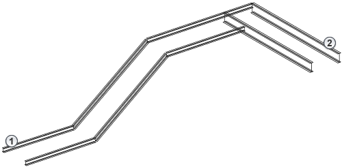

  3. Select a start and an end point to define the length of the handrail.

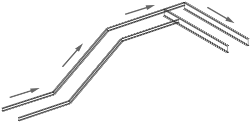

    Tip: When you select multiple beams, the start point of the hand-railing should be on the first beam and the end point on the last beam. Note that each change in direction represents a new segment. Segments can cover multiple consecutive beams.
