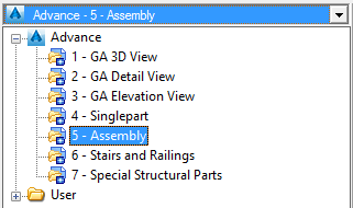

sign, the tree branch expands. The drawing styles in the tree are separated into two main categories:
- Advance - This category includes all the drawing styles available in Advance Steel. Their properties cannot be modified. If additional country settings are installed, a category will be created for each country setting.
- User - This category includes a copy of all the drawing styles from the Advance category that can be modified at any level.

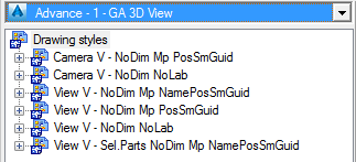

The drawing styles are grouped in categories.
A category is selected using the drop-down list above the tree panel. The tree panel displays all the drawing styles in the selected category.
To view the entire tree, select the Show full tree option from the Options menu.
