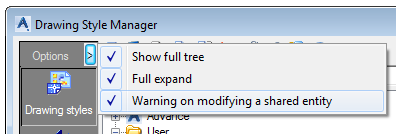

All the existing rules, views, and presentations are reusable, so any edit can affect other drawing styles. When editing or creating copies to start the work, never edit without creating or copying a rule and be sure to minimize the amount of copies, reusing as many existing settings as possible.

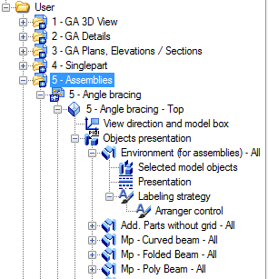

The following image highlights the layout structure of a drawing style:
Selected model objects, presentation and labeling strategies are core settings which directly communicate with Advance Steel, while the upper settings in the tree are saved rules that reuse certain configurations. Editing any settings of an existing drawing style requires a set of copies of the rules that are above that respective setting, including the drawing style itself.

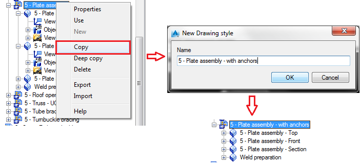

- Make a copy of the drawing style. Select the style, right -click and choose Copy from the contextual menu. Always use Copy instead of Deep copy. The copied drawing style will keep the existing views and settings, so at this point there is no difference between the two styles, except the name.

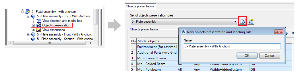

- Expand the Object presentation page for the first view and create a copy of it.
- Add the Anchor presentation rule to this object presentation.

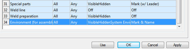

(Add a new object presentation). This will add a new line at the bottom of the list, containing values copied from one of the existing entries (generally the first line is copied). The object presentation rule will contain a duplicate entry. The new line will store the necessary modifications to add the anchor object to the plate drawing style. You can reuse existing configurations to add the anchor as they are core settings which do not require a copy.

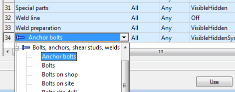

- Specify the model objects as anchor bolts.

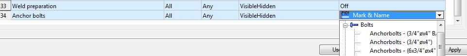

- Specify a labeling strategy for those anchors under the Bolts category. If no label is required, select Off.
