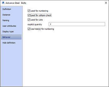

For bolts and anchors, you can find the Use hole(s) for numbering box, in the Hole definition and in the Behavior tabs of the properties dialog.

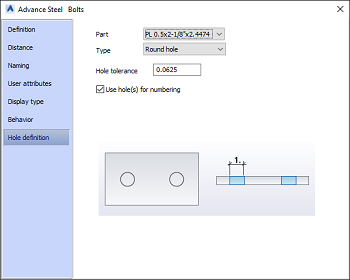

The Use hole(s) for numbering option is set only for the holes on the selected part. |
The Use hole(s) for numbering option is set for the holes created by the bolt on all connected elements. |
| THE USE HOLE(S) FOR NUMBERING CHECK BOX STATES | |
| The Behavior tab controls the holes created by the selected bolt or anchor on all the connected elements. | The states can be:
| For holes, you can set the Use hole for numbering option in the Hole definition tab of the properties dialog. | |

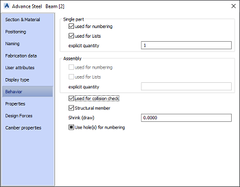

For host elements such as beam and plates on which holes, bolts or anchors are placed, the Use hole for numbering checkbox is found in the Behavior tab of the properties dialog.
![]() Note:
If you check or uncheck the box in the host element properties, the state of the Use hole for numbering checkbox will be modified at once for all the holes (individual holes and holes created by bolts or anchors) created on that specific element. Host elements which do not have any holes will have the Use hole for numbering checkbox greyed out. |
The states can be:
