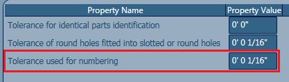

- Tolerance: When the geometry is compared, Advance Steel uses a prest tolerance value to allow very small differences to not interfere with the grouping process. This tolerance works as a length based setting, used not only to compare one of the object sizes, but it can also represent a combination of geometric differences. You can configure the tolerance using the Tolerance used for numbering default value from
(Management Tools)
Defaults:

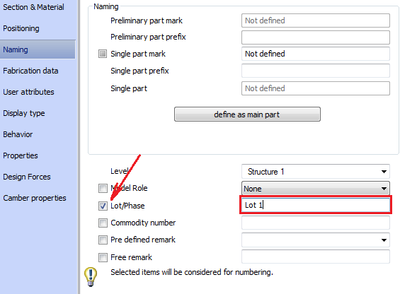

Tip: The tolerance value should be a reasonably small value. A very small tolerance will trigger Advance Steel to find apparently identical assemblies as different (the tolerance can even be set to zero), while a large tolerance (e.g. 1") will group different assemblies into the same part mark. - Value triggered differences through the object attributes:
