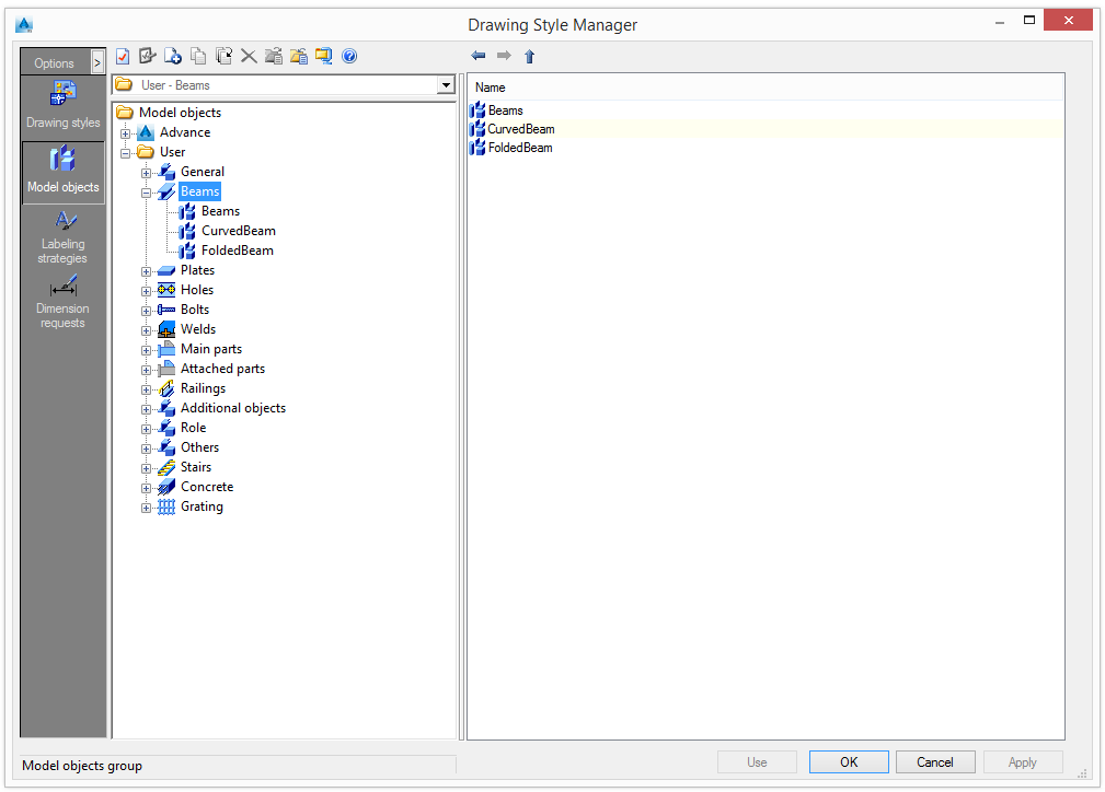

Model Objects
You can assign functions to the model objects either by applying construction rules or interactively.
In the drawing creation, these functions are used to explicitly differentiate individual object groups.
The cover plate, end plate and butt plate functions automatically create a front plate view in a main part. If no other elements, such as shear or gusset plates, are welded at this spot, no further cut is offered by Advance Steel.
