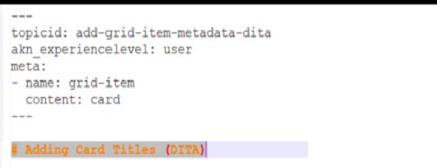

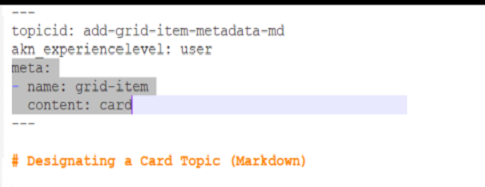

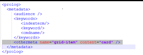

Authoring Cards
A card has three visual elements: title, description, and image. The whole card acts as a link to the corresponding card topic. A card topic can essentially be any topic that is designated as a card.

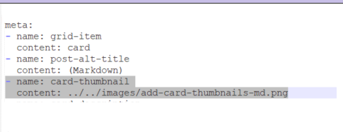

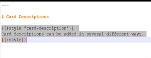

Markdown
Use the #style helper as the container.
{{#style "whatsnew-collection-list"}}
add-grid-item-metadata-dita,
GUID-081B7FFA-F313-464B-85A5-A060AA9EB44A,
add-card-descriptions-dita,
GUID-42EA9825-C1D3-4DC3-B213-BA171F239E59
{{/style}}

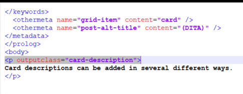

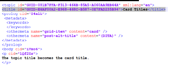

DITA
Use the section element as the container. Set the outputclass attribute to whatsnew-collection-list.
<section outputclass="whatsnew-collection-list" id="GUID-4C232123-DB2D-4B99-9A0C-F19F91CB0416">
<p>GUID-4DA256DF-A803-4AB5-8D20-7D1C6D033E81,GUID-E1E0A5AC-5605-4051-B8F1-DE467CF04691,
   whatsnewcard-eight,
   whatsnewcard-five</p>
</section>
