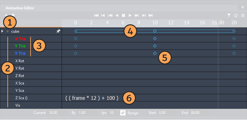

Objects are listed as nodes and groups in the same way as in the Object Lister with an extra level of hierarchy displayed for NURBS geometry showing the CVs. Shader and Light Parameters are also shown. The filter icon affects which objects are displayed.

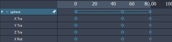

Parameters are the attributes of the node that can be animated. These are displayed in neutral color when no animation has been applied.
Channels are Parameters that have been animated and are shown highlighted in XYZ color. Channel data describes the value of its parameter at different frame times during the animation playback. The relationship between an animation parameter and its channel is made implicitly by using the same name for both.
Actions show the duration of the animation. These are displayed as a summary bar at the node level and as individual keyframes at the parameter level.
Keyframes set the time, value and Tangent Type settings for the node. These settings can be accessed and changed using the RMB context menu on the keyframe diamond icon.
Expressions add animation to node without the need to set keyframes. An expression can be added by double-clicking in the action section of a parameter and entering the syntax as described in the Expressions Syntax reference.

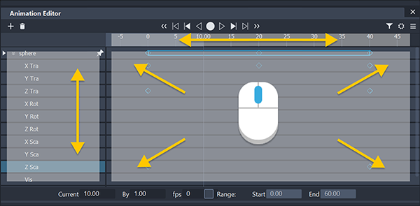

Animation Editor - Mouse interactions
Keyframes can be moved left and right to change the timing of the animation. Moving Keyframes on the Action Summary Bar also moves and adjusts the channel keyframes below. Individual parameter keyframes below can be moved independently.
missing Gif
The mouse scroll wheel can be used to navigate the regions of the editor as shown below.
Shift + Alt with MMB and RMB can also be used to move around the Actions and Channels main window.
missing Gif

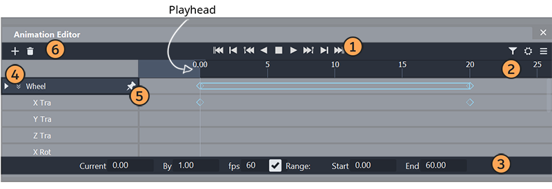

Playback Controls
  • - Play Forward/Reverse.
  • – Next/Previous Keyframe.
  • – Next/Previous Frame.
  • - Skip to Start/End.
  • - Stop playback.
    • Note: Clicking anywhere in the Alias window also halts the animation playback.
Timeline and Playhead - Click and drag to move the playhead. This is the current frame of the animation. Use the scroll button to move the timeline left and right.
Playback Settings
  • Current – Displays the frame that the playhead is at. Enter a value to move the playhead.
  • By – Playback shows every frame when set to 1.00. For example, set to 2 to view every second frame only.
  • FPS - Frames per second. If this is set to zero, then the animation plays back as quickly as the graphics allow. To achieve a controlled playback, enter a frame rate (for example 25 fps).
  • Range – If Range is On, then enter Start and End values to set the time period for the playback. If Range is Off, the animation plays from the first to the last keyframes and continue in a loop. Sometimes this does not correctly update to a change in timing. In this case, use Range to set the required playback period.
Expanders
  • Expose or hide the node hierarchy.
  • Expose or hide the parameters for each node. This icon also indicates when a parameter has animation channels with a highlighted color and emphasis.
Pin - Select the pin icon to fix a node in the node list, regardless of the filter settings. Pinned nodes move to the top of the list so you may see some reorganization of the list.

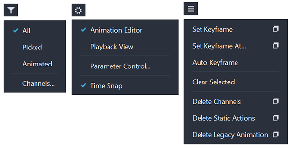

Shortcuts - Shortcuts for Set Keyframes and Delete Channels for the selected item in the node list. Click on the node or parameter name in the list. Use Shift to select multiple items.

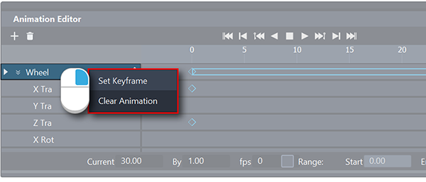

Context Menu for the Object List
missing image
To select multiple nodes, use the Ctrl key with LMB first. The context menu tools will then apply to all the selected nodes.
The context Set Keyframe tool uses the following settings:
  • Parameters: Global - Refers to the Param Control Settings.
  • Hierarchy : None - Only sets keyframes for the selected node or parameter.
  • Tangent Type: As set in the Animation > Set Keyframe tool options.
  • Overwrite Tangents: On
The context Clear Animation tool uses the following settings:
  • Channel Types : Both - Deletes animation channels and expressions.
  • Objects : Active - Deletes channels only for the selected node or parameter.
  • Parameters : All - When used at the node level, it deletes all channels for all parameters. This doesn’t refer to Param Control settings.
  • Hierarchy : None - Only deletes channels for the selected node.

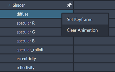

Setting keyframes for shader, light or texture parameters
The only way to set a keyframe for shader and light parameters is to use the context menu. Shader parameters appear under the shader node. Make the adjustment in the Shader Editor or Light Editor, and then use the context menu to set the keyframe on the selected parameter.

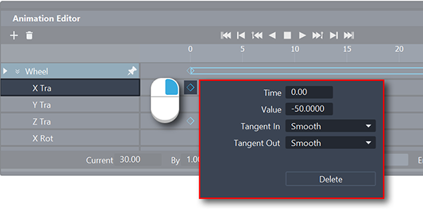

Context menu for Keyframes
missing Gif
The Keyframe context menu works on individual parameter keyframes and not on the keyframes embedded in the action summary bar for the nodes.
Click outside the settings window within the Animation Editor to close.
Multiple keyframes can be selected using the Shift key, but the context menu only applies to the keyframe selected with RMB.
Translation values are displayed in centimeters.

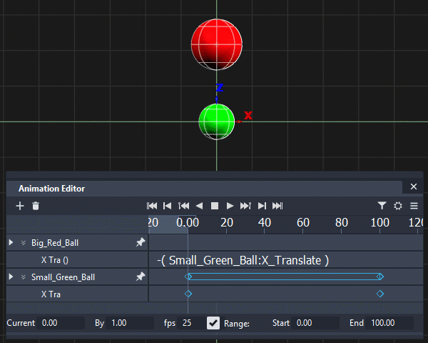

For example, an expression can reference another channel that has been keyframe animated:
missing Gif

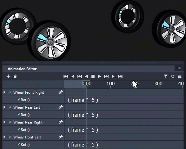

An expression can reference the frame and create an ongoing motion that continues indefinitely:
missing Gif
