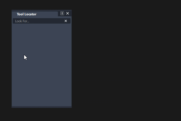

Tool Locator
Finds tools or menu items in the interface that match your search phrase. Type part of the name of the tool or menu item you want to find. You can use regular expression matching.
As you begin typing, the Tool Locator window automatically populates with results based on your query, narrowing the search as you type more of the tool name. Select the tool icon or menu item from the Tool Locator to activate that tool or open the menu item.

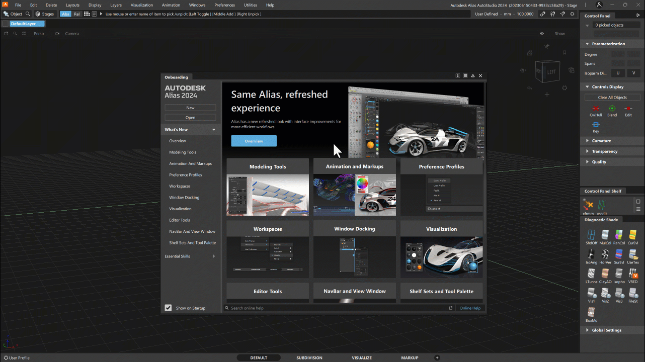

Essential Skills
Opens the Alias Application Home (Onboarding) window, which provides information on what's new and demonstrates essential skills for both new and experienced users to get started in Alias right away.
See the highlights of What's New in this version of Alias, and click the Learn More button for additional information on each topic in the online help.
Learn essential skills by watching the tutorial videos in the Essential Skills section, and click the Learn More button to visit the online help page for more details. You can also watch the videos online with subtitles by clicking the Watch Online links.
You can create a new empty wire file or open an existing one directly from the onboarding window. Click the arrow next to the Open button, then select Open Examples... to try working with an example file. Click Recent to quickly access to your recent files. Display them in list view for file details or switch to grid view to see larger file previews, and select a file to continue working where you left off.
The Application Home can also be opened by clicking the Home icon in the top left corner.

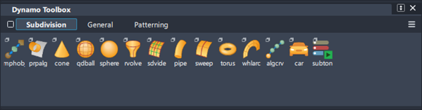

Dynamo Toolbox
Opens the Dynamo Toolbox window, which displays icons for the Dynamo Player scripts installed with Alias. Clicking an icon launches the script in Dynamo Player.
For more information, see Dynamo Player sample scripts.

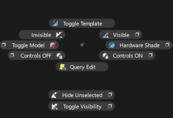

Marking menus
Hold Shift + Ctrl and press one of the mouse buttons.
Ctrl + Shift +
Ctrl + Shift +
Ctrl + Shift +

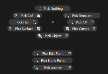

Picking
To...Click or drag
Toggle between picked and unpicked
Pick only
Unpick
Tip: Hold Shift within a non-picking tool to temporarily switch to picking mode.

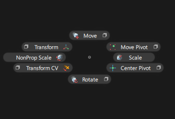

Transforms
To transform in...Click or drag
X
Y
Z
Move, scale, rotate, or flip
Snap to...HoldOr click
Curves, isoparametric curves, surface edges, or curves-on-surface.Ctrl + Alt
Grid intersections.
Alt/p>
CVs, edit points, pivot points, locators.
Ctrl
