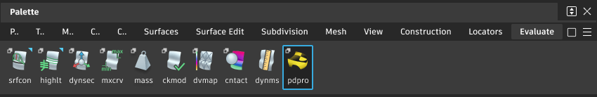

Access this tool from the Evaluate palette:

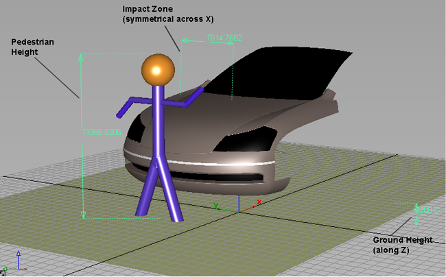

- Pedestrian height
- Width of the impact zone (on each side of the center line)
- Ground height
- Car hood surfaces
(All distances and heights are in current units.)

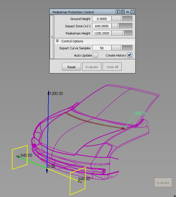

Pedestrian Protection Control settings
Ground Height
Ground plane location (height along the Z axis in current units). The default is Z = 0.
Impact Zone (+/-)
Distance from the centerline (along the Y axis) that defines the impact zone. This will be the extent covered by the output curve. The default is +/- 600 mm.
Pedestrian Height
Height of the pedestrian in current units. The default is 1250 mm.
Control Options
Impact Curve Samples
Number of points calculated for the output curve. This also corresponds to the number of spans since the curve has degree 1.
Auto Update
When this is checked on, the impact curve updates as you change the values in the Pedestrian Protection control window.
Create History
When this is checked on, construction history is created for the impact curve. After leaving the tool, you can modify the surfaces and the impact curve will update.
Buttons
Evaluate
Click this button to re-calculate the impact curve if Auto Update is turned off.
Undo All
Removes the impact curve and de-select the surfaces. The values in the control window are not reset.

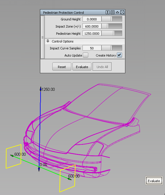

Generate an impact curve
Select the surfaces that define the front of the vehicle.
The surfaces turn purple.
A manipulator appears 100 mm in front of the selected surfaces.
Note: Surfaces that were already picked prior to accessing the tool are included in the selection.
Adjust the parameters (Pedestrian Height, Impact Zone and Ground Height) through the control window or by dragging one of the manipulator arrowheads.
Note: The manipulators move in 10-unit increments. You can also enter a more precise value through the keyboard.Click the Evaluate button (either in the control window or at the bottom of the active view window) or press the space bar.
The impact curve is calculated and drawn. An annotation is attached to the curve showing the corresponding pedestrian height.
Modify the Pedestrian Height, Impact Zone or Ground Height through the control window, or by dragging one of the manipulator arrowheads.
Add or remove surfaces from the selection by clicking on them.
Note: In the default configuration, the
toggles the selection.Click the Evaluate button again.
The impact curve and its annotation update.
