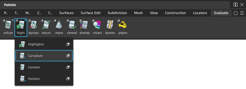

Access this tool from the Evaluate palette:

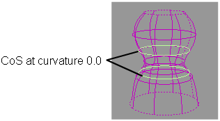

To create curves-on-surface along lines of constant curvature
Pick the surfaces on which you want to create curves-on-surface.
Shift-select the Curvature tool.
The Curvature control window opens.
Click the Go button.
Curves-on-surface are created.
Set the following options in the control window:
- The Curvature Type.
- The Curvature Value at which you want to create curves on surface. For example, enter 0 to create curves-on-surface along inflection lines.
- Set the Subdivision option from 1 to 6. The higher the number, the more precise the result. Use low values for draft quality, use higher values for final results.
The curves-on-surface update as the option values are modified.
If Auto Update is off, click Update to create the curves-on-surface.
Click on additional surfaces to evaluate them, or deselect active surfaces.
Click the Undo All button in the control window to remove the curves-on-surface.
