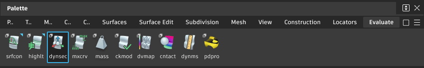

Access this tool from the Evaluate palette:

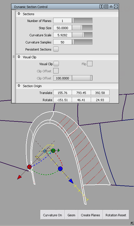

Dynamic Sections Control
Sections
Number of Planes
The number of cross-section lines to create.
Step Size
The distance between cross-section lines (when Mode is Parallel and Number of Planes is greater than 1).
Curvature Scale
Controls the size of the curvature combs on the cross-section lines.
Curvature Samples
Controls the number of equally-spaced quills that appear on the curvature combs. The default is 50.
Persistent Sections
This flag determines whether the sections will remain after exiting the tool. Supports Query Edit.

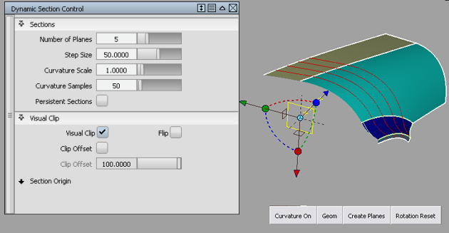

Visual Clip
These options let you visually clip the wireframe and shaded model, leaving the sections visible.
Visual Clip
Check this option to display only the part of the model with the sections (on one side of the sectioning plane).
Flip
Check this option to display only the part of the model that does not have sections. The sections on the invisible part are still displayed.

Section Origin
Translate
These fields specify the position (X,Y,Z) of the sectioning plane’s origin. They let you cut a section at a precise location along one of the main world axes (for example x = 100).
Rotate
These fields specify the rotation angle of the sectioning plane around the world X,Y,Z axes.
Click the Rotation Reset button in the view window to reset all rotations to 0.

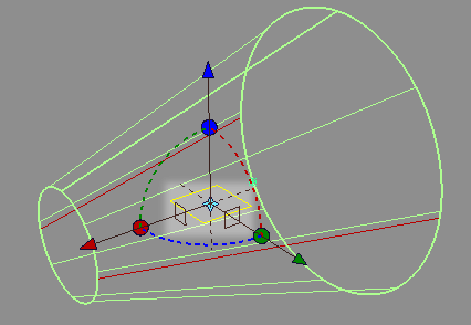

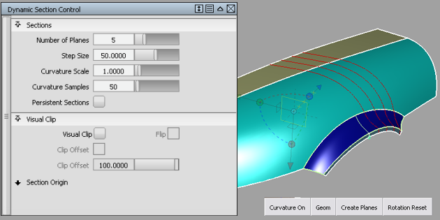

  1. Pick the surfaces or meshes you want to examine.
    A sectioning plane appears, at the geometric center of the object(s). A red cross section appears on the selected objects where the plane intersects them.
    Note: At any time you can click additional surfaces or meshes to add to the selection. Clicking an already selected surface or mesh removes it from the selection. (You can use a pick box instead of clicking.)
  2. Set the Number of Planes (number of sections) and Step Size (spacing between sections) in the option box.
    The cross sections appear as red lines and update on the objects.
  3. Use the manipulator to orient the sectioning plane, or enter specific values in the Translate and Rotate fields in the control window.
  4. Changing these values update the plane manipulator, and vice-versa.
    The cross sections update as the plane is moved/rotated.
    Note: Using the Translate fields lets you cut a section at a specific location along one of the main world axes (for example X = 100).

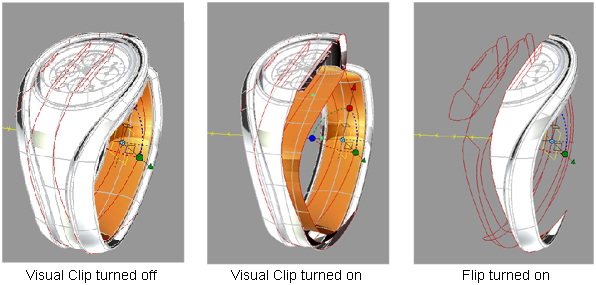

    • Turn on Visual Clip in the control window, to see only the part of the model in front of the sectioning plane. Turn on Flip to see only the part of the model behind the sectioning plane.
    • Turn on Visual Clip and Clip Offset to create an additional plane parallel to the sectioning plane, and see only the part of the model between the two planes.

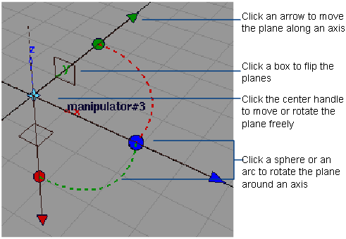

How do I use the manipulators?
The manipulators are visible through shaded geometry.
Sectioning Plane
  • Drag a handle to move/rotate.
  • Click an arrow to change the center handle to the free move handle. Then drag the center handle to move the plane freely.
  • Click a sphere or arc to change the center handle to the free rotate handle. Then drag the center handle to rotate the plane freely.
  • Click a box (square) to set the plane perpendicular to one of the manipulator axes.

Define two visual clipping planes
You can define a secondary visual clipping plane parallel to, and at a given distance from, the primary clipping plane. Only the part of the model between the two clipping planes is displayed.
This secondary plane is always driven by the location and direction of the primary plane.
  1. Select surfaces or meshes
  2. Shift-select the Dynamic Section tool icon to open the control window.
  3. Adjust position and orientation of the sectioning plane.

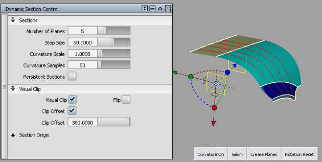

  4. Turn on the Visual Clip option.
    The display of surfaces/meshes is clipped to the location and direction of the current plane.

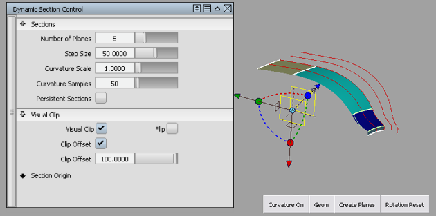

  5. Turn on the Clip Offset option.
    An offset plane appears, and the display of surfaces/meshes is clipped to the location and direction of that second plane as well, leaving only the part of the model between the two planes visible.
  6. Use the Clip Offset slider, or click and drag the offset plane manipulator, to adjust the offset distance of the second clipping plane from the first.
    The clipped area updates.
    Both the slider value in the option window and the offset plane manipulator on the model update to reflect each other.

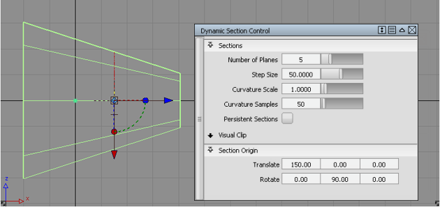

Cut a section at a specific location along one of the main axes
  1. Choose the orientation of the sectioning plane by clicking on one of the three square icons on the manipulator.
  2. Enter the X, Y, or Z location of the plane in the appropriate Translate field.
    A discreet section cut at x = 150.0
