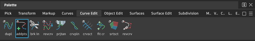

Adds control points to the end of an existing curve, as if you are still drawing it using the new curve tools.
Access this tool from the Curve Edit tool palette:
