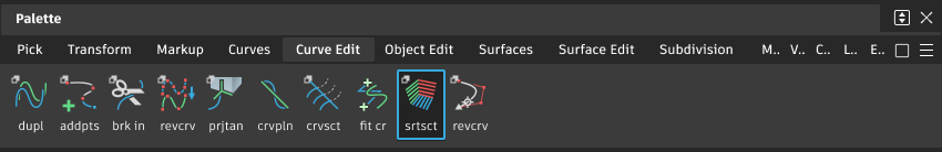

Access this tool from the Curve Edit tool palette:

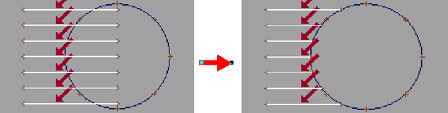

  • Trim – Trim back curves by deleting the part of the curve beyond the intersection point. The part of the curve you clicked is retained.
  • Segment – Detach the curves at the intersections.

Slice a group of curves at their intersections with a sectioning curve or surface
  1. Double-click the Curve Section tool icon.
  2. Do one of the following:
    • To trim the curves, set the Sectioning Mode to Trim.
    • To detach the curves, set the Sectioning Mode to Segment.
    • To insert edit points on the curves, set the Sectioning Mode to Slice and the Slice Creation Mode to Insert Edit Points.
    • To create a new curve that passes through the intersections, set the Sectioning Mode to Slice and the Slice Creation Mode to Create Curve.
  3. Set the Sectioning Criterion to Geometry, then click Go.
  4. Pick the curves or curves-on-surface you want to trim, in the view window where the curves and the sectioning curve/surface intersect.
    For trims, click the part of the curve you want to keep. Red arrows show the “kept” part of the curve.
  5. Click Go.
  6. Click the curve, surface, or construction plane that you want to section with.
