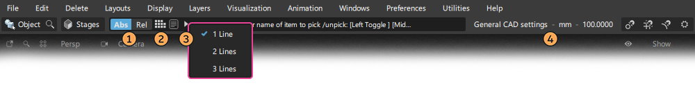

We've added new functionality to the promptline input and tools, including Hotkey mode switching.
The promptline now includes these options:
Toggle between Abs and Rel to enter absolute or relative numeric values. Typing
aorrin the promptline still works in the same way as before.New promptline input modes:
Automatic (default) - There is no need to move the mouse to the promptline. Keyboard number input is automatically sent to the promptline as input. When you start to type, a blue line is displayed below the promptline entry area. In this mode, single hotkeys can be used, excluding the reserved keys: a, r and numbers, which are interpreted as coordinates or value inputs.
Tab - Use the Tabkey or click in the promptline to activate it for number entry. A blue line is displayed below the promptline entry area when it is activated for number input. In this mode, any hotkey can be assigned including a, r and numbers.
Note: To enter text strings, you need to pressTabor click in the promptline for both modes.Specify the number of lines to display in the promptline. Click on the arrow icon to select 1, 2, or 3 lines for permanent promptline display. You can still use the promptline history icon to open a floating window that displays the full prompt history.
Display of the current Construction Tolerances, units, and grid spacing.
