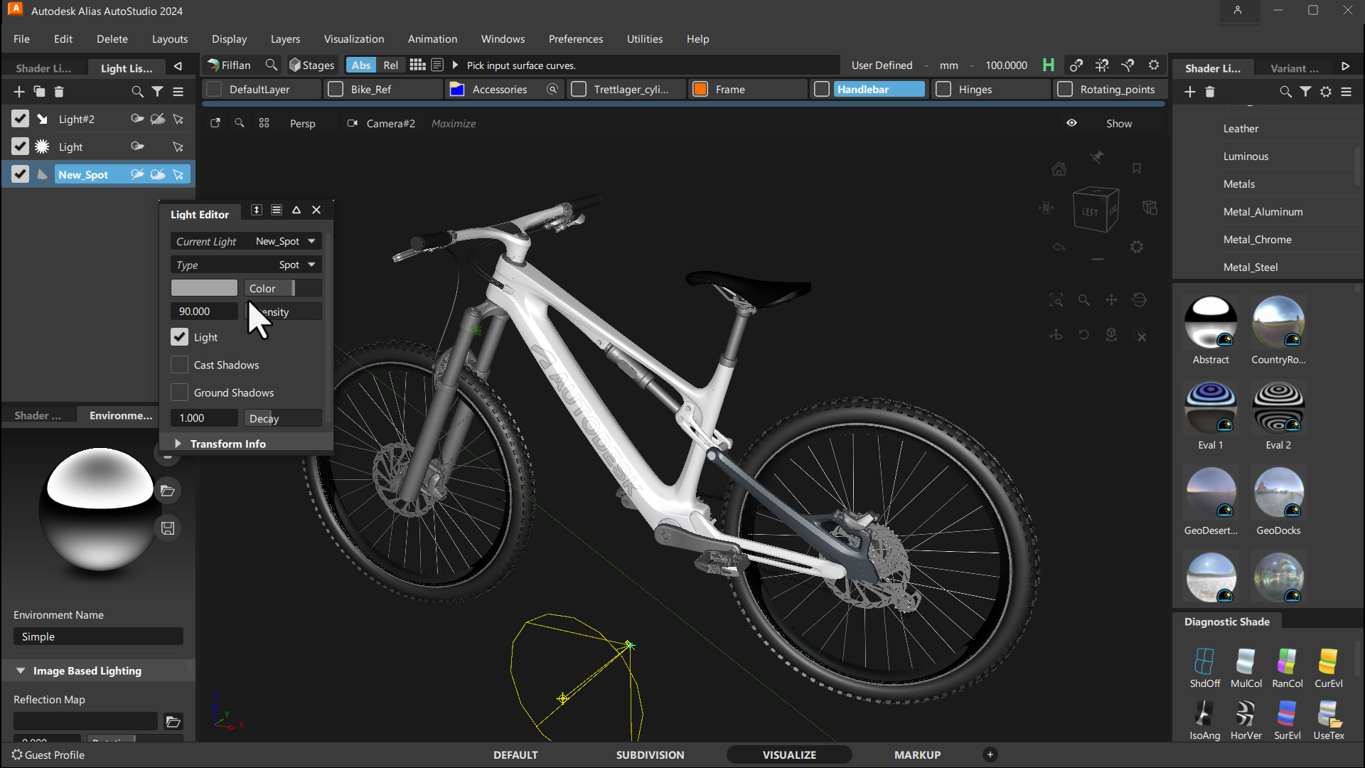

New Light Lister and Light Editor
Video Player is loading.
Current Time 0:00
Duration 0:00
Loaded: 0%
Progress: 0%
1x
Video contents
  • Alias 2024 includes a new Light Lister and Light Editor.
  • Create a new light by clicking the Create Light icon.
  • Each new light displays in the window along with controls for toggling the light and shadows on and off.
  • Double-click the light to rename it.
  • If the Light Editor is not already open, clicking the Edit Light icon will opens it.
  • You can then adjust the parameters of the selected light.
For more information, see the following:
