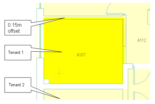

Tenants/Units
When selecting the SIS area calculation standard in AutoCAD Architecture 2026 toolset, the zone style Unit Usage_SIS will automatically be created. This zone style can be used to specify the usage of the spaces in the drawing. The calculation of the usable boundary is dependent on whether the adjacent spaces are in the same unit or not. The usable boundaries are created to the interior side of the wall when the adjacent space is attached to another zone. If the adjacent space is attached to the same zone, the usable boundary is offset 0.15m into the wall.

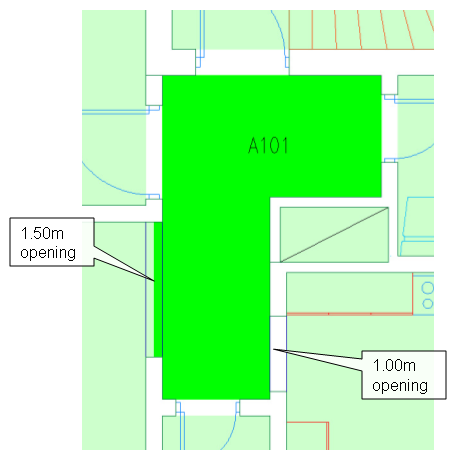

Net Area (NTA)
The following rules apply to the generation of net boundaries with the SIS standard:
- The net boundaries are measured to the inside of the wall.
- If wall openings have a width larger than or equal to 1.50m, the net boundaries are offset to the center of the wall.
- If doors have a width larger than or equal to 1.50m, the net boundaries are offset to the inside of the door frame.
- If wall openings have a width smaller than 1.50m, the net boundaries are measured to the inside of the wall.

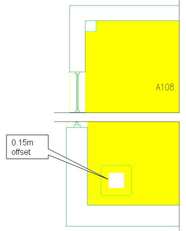

- If columns are set to bound spaces, the usable boundary will be offset 0.15m into the column. The rest of the column area will be subtracted from the usable area.
Freestanding columns are calculated as an interior wall. The usable boundary is offset 0.15m into the column.
