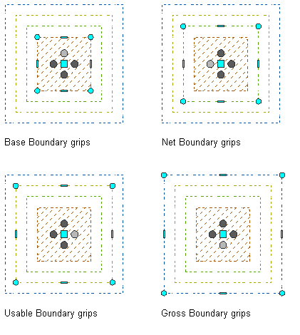

Spaces have 4 boundaries.
Depending on which type of space you have created and which boundary offset type you use, different boundaries can be edited with grips:
| Space Type | Boundary Offset Type | Editable Boundaries |
| Associative | Manual | Net, Usable, Gross |
| Associative | By Style | None |
| Non-Associative 2D or extruded 3D | Manual | Base, Net, Usable, Gross |
| Non-Associative 2D or extruded 3D | By Style | Base |
| Non-Associative 3D Freeform | Manual | Net, Usable, Gross |
| Non-Associative 3D Freeform | By Style | None |
Attention: The net, usable, and gross boundaries of a space can only be displayed in plan views. In model views, only the base boundary and the base body of the space are displayed.
Editable boundaries of a space with manual offsets
