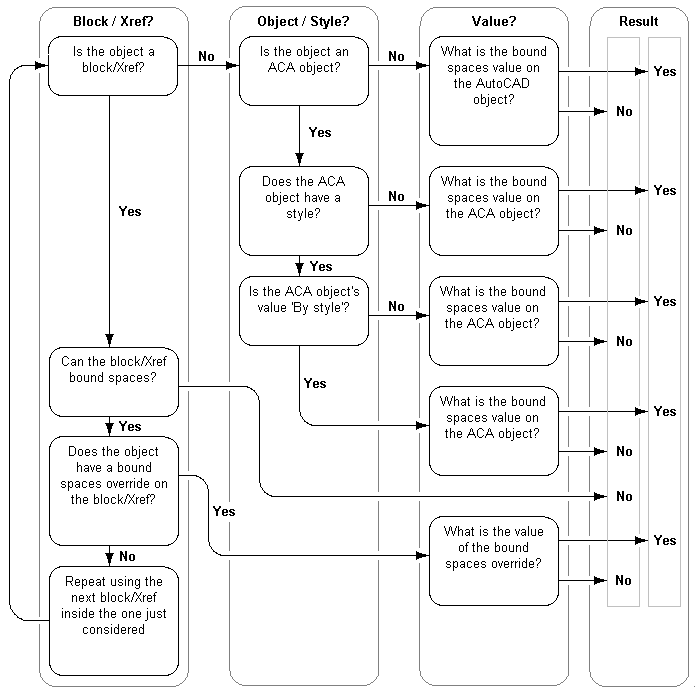

The following overview graphic shows how the setting of the Bound Spaces property on the boundary object affects the generation of associative spaces. For detailed information on how to set the Bound Spaces property for a boundary object, consult the sections following below.
Note that the term “AutoCAD object” in the graphic below refers to AutoCAD linework (lines, arcs, circles, and polylines etc.)
