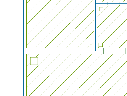

transaction.Commit(); } return result;
The figure below shows an example of applying this rule, where the net boundary (green) includes the columns, while the gross boundary (blue) ignores them
