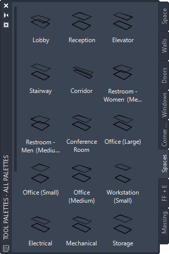

Tools provided with AutoCAD Architecture 2026 toolset let you quickly place spaces by selecting a space tool with a specific space style and other predefined properties. You can use the tool with its default settings, or you can change any properties that are not controlled by the style. You can also use space tools to create new spaces by applying tool properties to existing objects.
Tool palette containing space tools
The default tool palettes in the workspace contain space tools that you can use and customize as needed. In addition, the following catalogs provided with the software contain space tools that you can add to your tool palettes:
  • Stock Tool catalog
  • Sample Palette catalog
  • Design Tool catalog
Custom palettes created by your CAD manager or other users may also contain space tools with space styles and properties that are customized for your projects or office standards.
