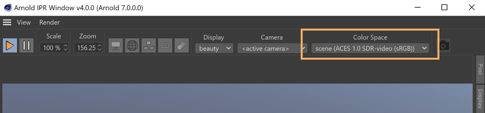

IPR Window
By default, the IPR window uses the same view color space defined in the render settings (ACES 1.0 SDR-video (sRGB)). You can select a custom view color space on the toolbar.
If the color space list is not visible, go to View > Toolbar > Show color space list to add it to the toolbar.
