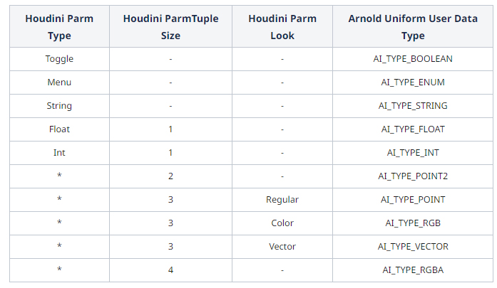

The Arnold type for the user data will be deduced according to the following table:
