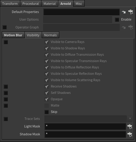

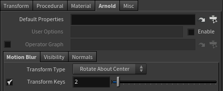

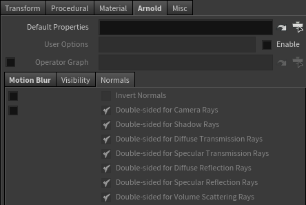

An Arnold procedural will generate geometry at render time, and it possible to override some of the properties of all the generated shapes. To do this, you must activate the left-most check box for each property you want to override.
Motion Blur parameters
Visibility parameters
Normals parameters
Only a subset of the geometry properties can be overridden. Please refer to the Motion Blur, Visibility and Normals property help pages for a full description.
