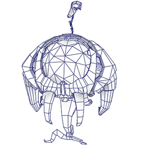

  • Start off by opening the Killamari model in Maya. You will notice that it is a low poly model. We can add geometry detail by increasing the number of subdivision_iterations using Arnold's Subdivision settings. We will also need to add subdivisions to the leg and tentacle models as we will be adding displacement to them.

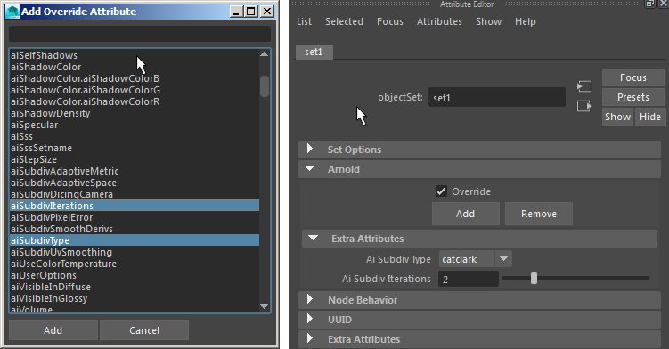

  • Select the body geometry (not the tentacles) and create a Maya Set for them.

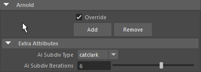

  • Select the Set and go to the Arnold tab. Click on Add to open the Add Override Attribute window.
  • We want to create a smooth surface for our model, so add Ai SubdivType and change it to catclark.
  • We will also want to add some subdivision iterations to smooth the model. Add Ai Subdiv Iterations to the Set and increase them to 2.
Subdivision Overrides assigned to body Set

  • Repeat the above steps by adding another Override Set to the leg and tentacle geometry. However, this time, increase the number of Ai Subdiv Iterations to 6. We will need these extra subdivisions to get the fine level of detail from the displacement map.
Override Set for leg and tentacle geometry

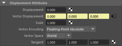

  • Select the Shading Engine for this shader and connect a displacement shader to the [*Vector Displacement*](topicid=arnold_for_maya_displacement_am_Vector_Displacement_html) attribute.
  • Select the displacement shader and connect the killamari_merged_appendages_vdm vector displacement map to the Vector Displacement.
  • Change the vector_space to world. This is the coordinate space where the vector is applied.
Displacement texture connected to the Shading Group of the body shader

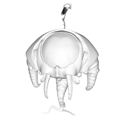

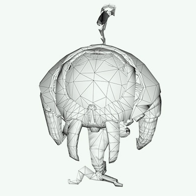

  • Render the scene. The vector displacement effect should be visible as in the image below.
with displacement without displacement

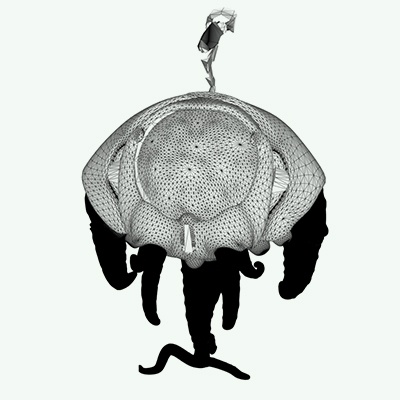

The utility shader can be useful for diagnosing issues when rendering displacement maps. It has a polywire mode that can be useful when test rendering displacement and subdivision. The leg and tentacles appear black because they have a high number of subdivision_iterations (6) whereas the rest of the body has only 2.
You can also use Feature Overrides if you need to disable rendering of displacement in the scene (useful for scene diagnosis purposes).
utility shader. Shade_mode set to ndoteye vs disable subdivision (Feature Override).
