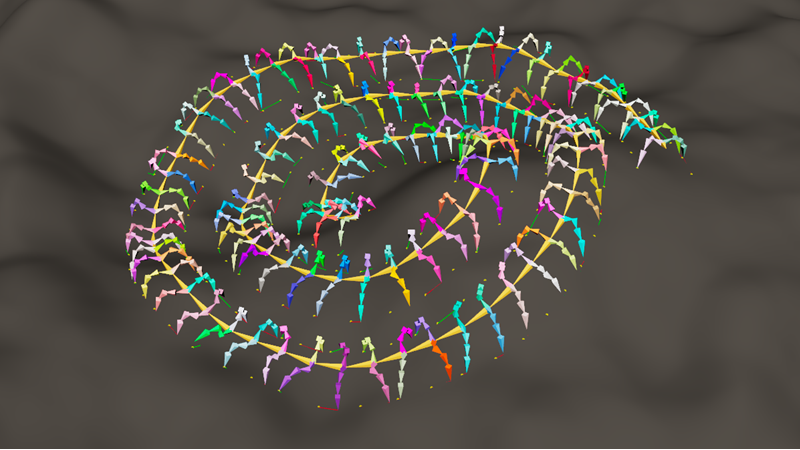

Walking centipede example available in the Bifrost Browser

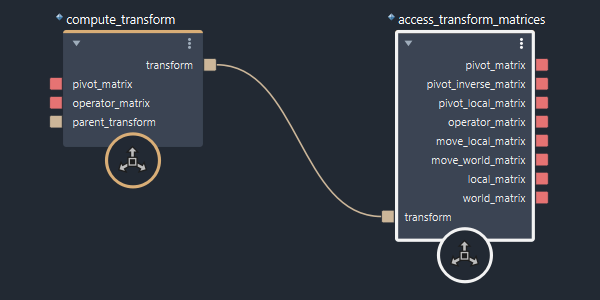

In addition to the pivot_matrix and operator_matrix inputs, the compute_transform node requires the following two matrices which are extracted from the parent's transform. These matrices are not directly included in the transform's data.
Matrix Description Formula
Parent Pivot Inverse The inverse of the parent's pivot. PP-1 (input directly)
Parent Move World The parent transform's move world matrix. MWP (input directly)

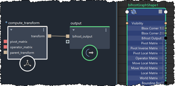

When you output a Transform value to the scene, its member matrices are available directly for connection in the scene graph. You do not need to extract and output these matrices individually.
Transform components output in the scene

A skeleton is a geometry-like object consisting of a tree of joints. It provides another way to deal with transformations by storing joint hierarchies as an object. You can create a skeleton from an array of pivot matrices and corresponding array of parent indices using construct_skeleton. Alternatively, you can construct a skeleton from an array of slash(/)-delimited strings using create_skeleton_from_paths.
To get an idea of how skeletons can be used, look at the following graphs in the Rigging category of the Bifrost Browser:
  • dancing_skeleton
  • maya_skeleton_to_bifrost
  • usd_skeleton_animation
  • usd_skeleton_skinning
  • walking_centipede
