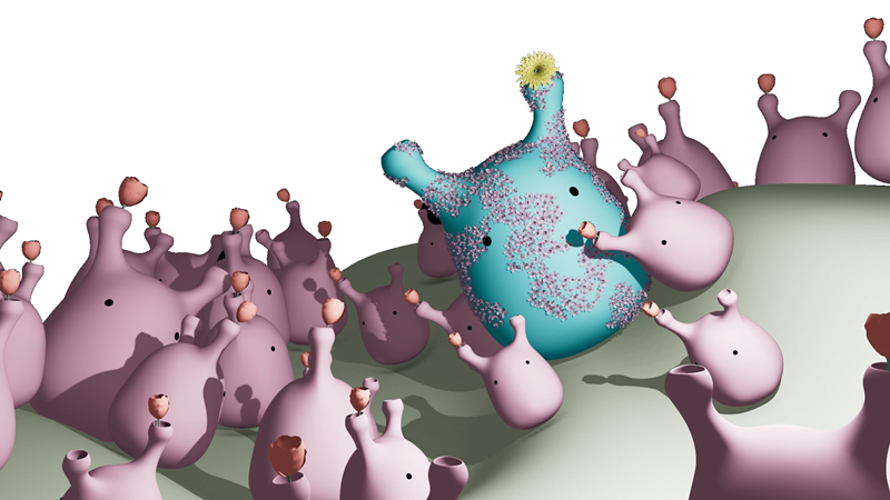

Instances created with Bifrost-USD
Bifrost-USD improvements
Bifrost 2.5.1.0 includes new Bifrost-USD nodes for binding materials and working with collections. The new shading and collection nodes are:
