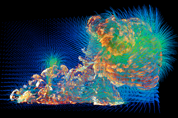

Velocity on refined VDB volume

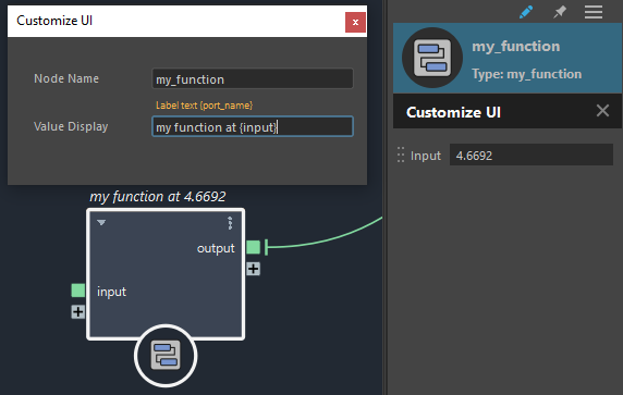

Value display expressions
You can add node value display to any node by renaming it with an expression that includes the name of an input port inside curly braces, for example, my function at {input}.
For editable compounds, you can also set a value display expression when the Customize UI editor is open by clicking on the compound's header on the Parameters tab. Display expressions are included with compounds that you publish.
In addition, value display now shows labels for combo boxes instead of the underlying values.

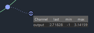

Detachable Watch Points
You can now detach a watchpoint from its connection wire by dragging its eye icon or the table header anywhere in the graph view. The table is joined to the wire to show which data is dispayed.
Detachable watchpoint
To return the watchpoint to the wire, double-click the eye icon or right-click the icon and choose Return to Wire. You can also remove the watchpoint itself by Alt+Shift+dragging across the dotted line.

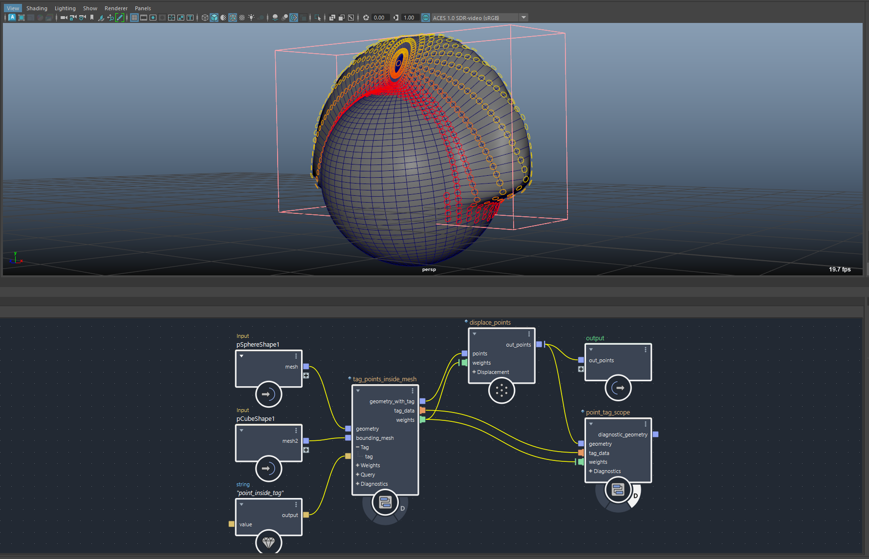

Component tags
Component tags on Maya scene geometry are now included when you import the geometry into the graph. You can control which tags to transfer in the parameters of the input node.
Tags are also included when you convert an output mesh to a Maya mesh. You can control which tags to transfer in the parameters of the bifrostGeoToMaya node in Maya's Node Editor.
Internally, tags are represented as arrays of Booleans, where true means that the corresponding point, face, or other component is a member of the tag. You can use the get_component_tag and set_component_tag compounds to work directly with tags in the graph.
Using component tags in the graph
The interpret_auto_port_as_component_tag node can convert between different representations of tags. It can accept a tag name (string), array of indices, or an array of Booleans and return both the corresponding array of Booleans and array of indices. This is useful for including in your own compounds for processing components that can be specified in different ways.
Mesh scope
The mesh_scope node can visualize data regarding points, faces, face edges, adjacency, face vertices, and more. It is very useful for diagosing issues with meshes.

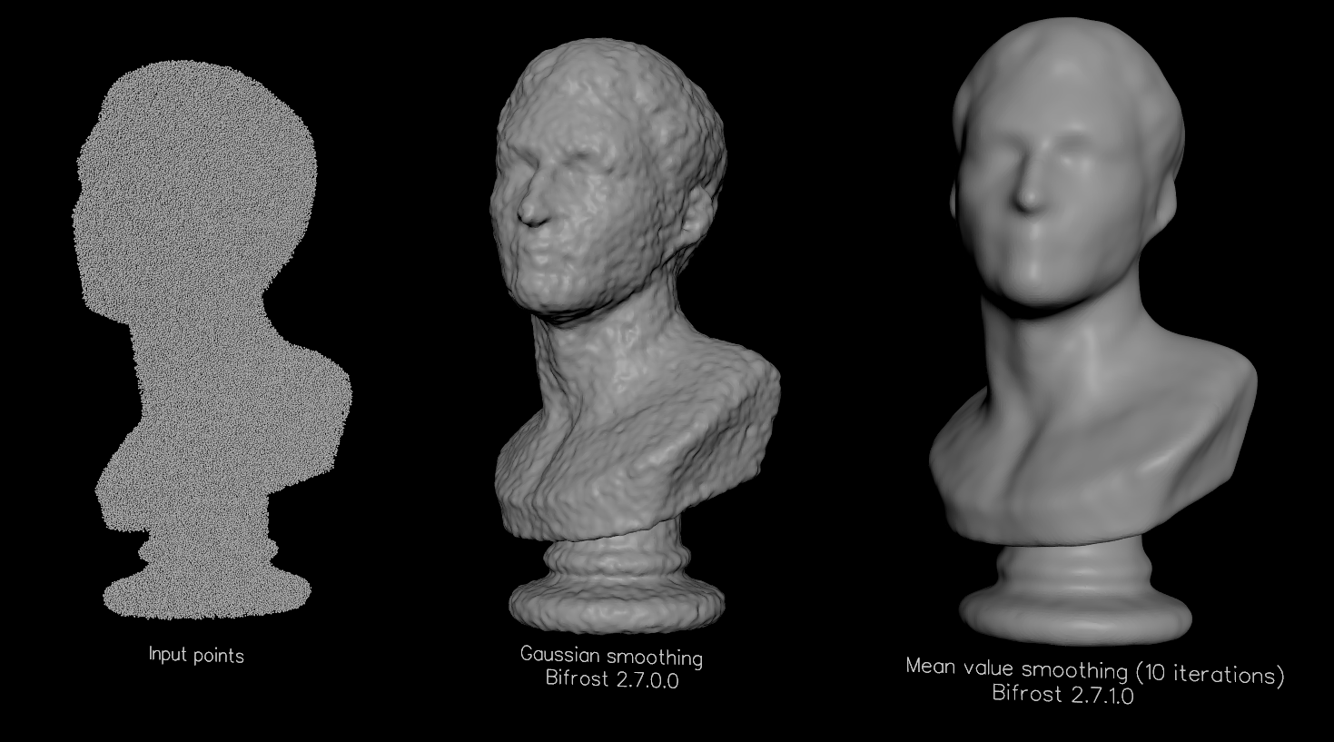

Voxel smoothing
The smooth_voxel_property node has new parameters that are especially useful for smoothing a level set that has been created from points or particles.
  • You can set the filter mode used for smoothing: Gaussian, Mean, or Median.
  • You can set the number of iterations for performing the smoothing operation.
Input points, level set with Gaussian filter, and level set with Median filter (10 iterartions)

Watchpoints: Detachable, resizable watchpoints BIFROST-4707
