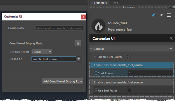

UI logic
You can now enable, disable, hide, and show parameters and groups based on the other settings in the Parameter Editor. For example, you can hide a color widget if the associated display option is toggled off. This UI logic has been added to many existing compounds to reduce clutter, and you can also use it in your own compounds.
Editing UI conditional rules
To add this logic when editing a compound's UI, select the parameter or group to be affected and click Add Conditional Display Rule in the Customize UI editor. The conditions that are available depend on the type of the controlling parameter (Boolean, integer, float, string, or auto). This creates a special group, and you can drag more parameters into it to control them by the same rule as well as drag the group itself. You can also nest these groups inside each other.

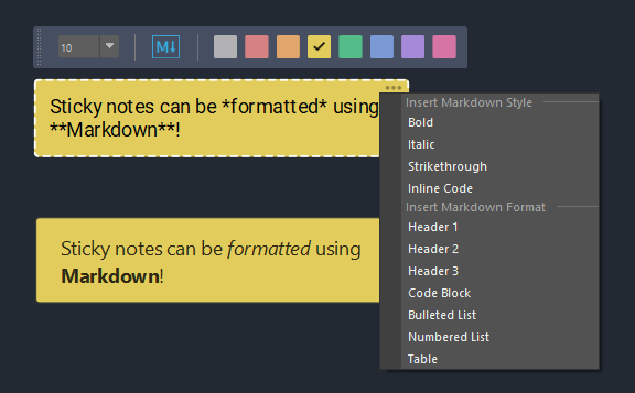

Formatted sticky notes
You can now format sticky notes using Markdown syntax. Click the Markdown button to activate formatting, then enter Markdown syntax manually or use the menu (right-click or click ... in the upper-right corner).
Markdown in sticky notes.
