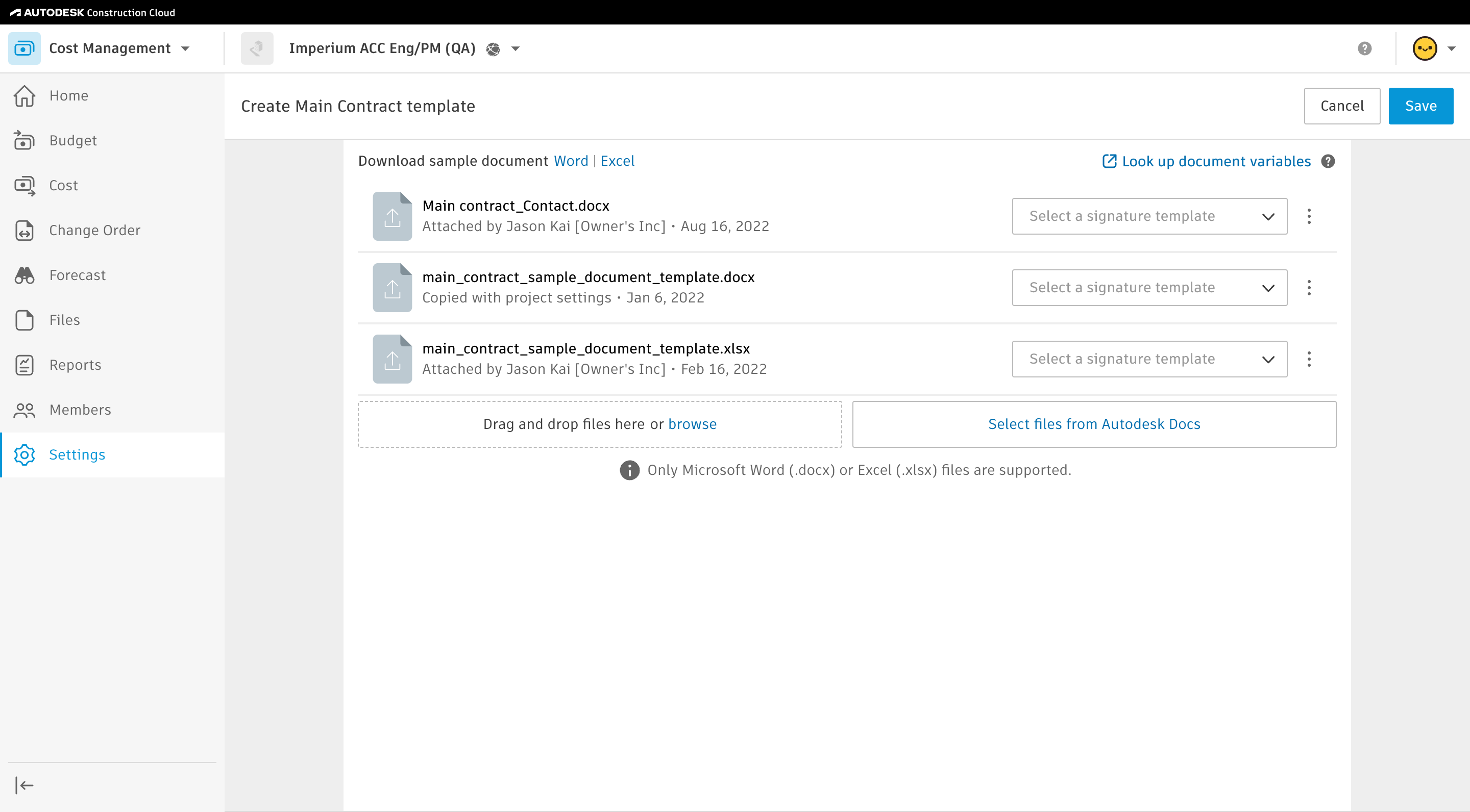

To access the Variable Finder for document template settings, follow these steps:
  1. Go to Settings.
  2. Select the tool for which you want to edit the template. For example, Budget or Main Contract.
  3. Click Edit.
  4. The template creation tool will open. Here, select Look up document variables in the upper right corner.
  5. After clicking, the ACC Cost Management Variable Finder will open in a popup window.

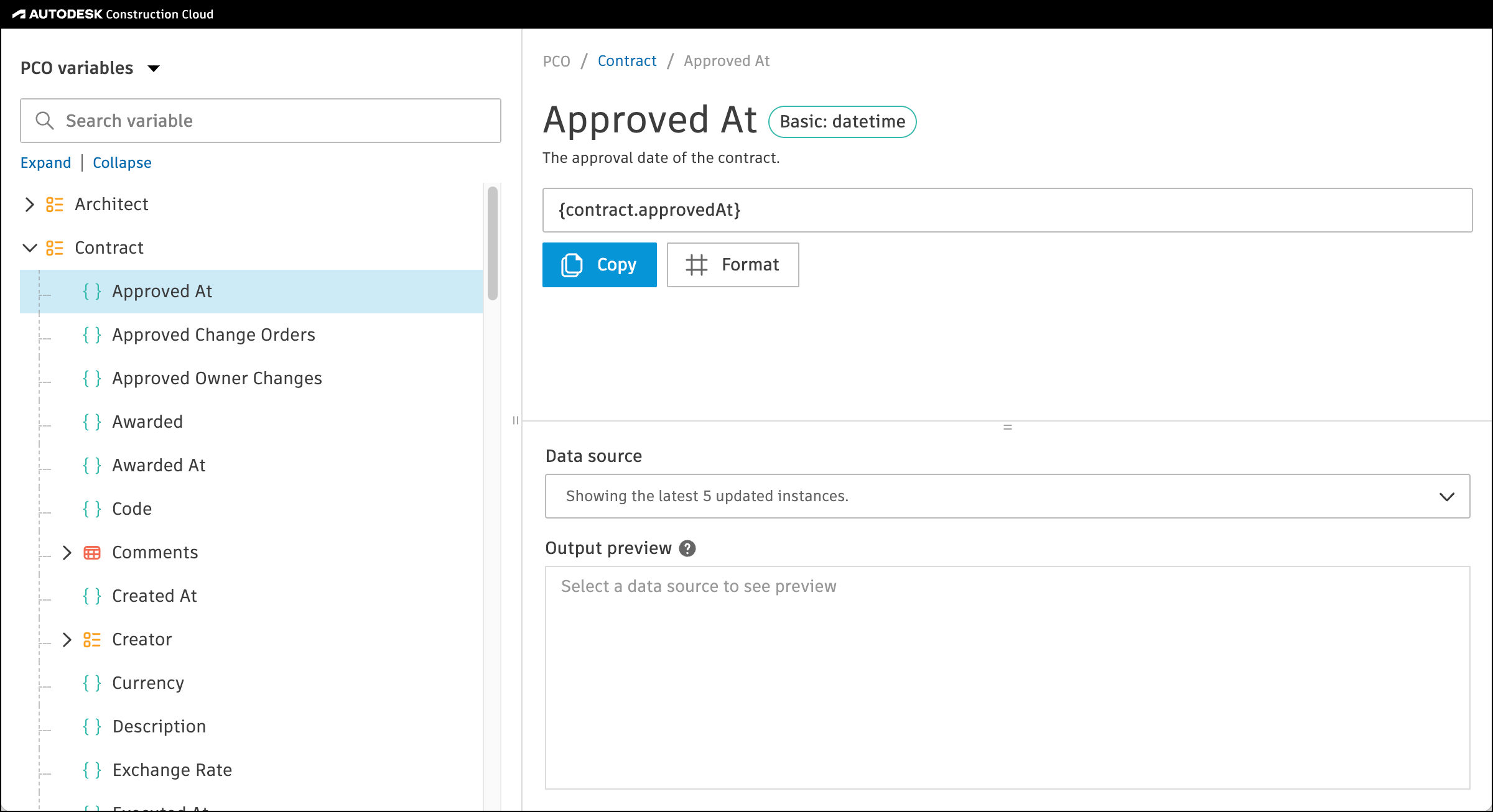

Finder Areas
The Variable Finder is divided into three main areas: Tree Area, Details Area, and Preview Area.
Tree Area
The Tree Area allows members to navigate through the variable structure. Members can adjust the width of this area by dragging the handle.
  • Variable Finder Title: Click the drop-down to switch between different modules.
  • Search Box: Members can search for variables in three ways:
    • By the full variable name (for example, mainContract.createdAt).
    • By the last node of the variable (for example, Created At).
    • By the description of the variable (for example, "Returns the creation time of the Main Contract").
Details Area
Details Area provides specific information about the selected variable.
  • Breadcrumb: Indicates the path of the variable for easy navigation.
  • Variable Description: Provides a brief explanation of the variable.
  • Variable Modification Area: Allows members to make changes to the variable.
  • Variable Field: Highlights the selected variable.
  • Copy Button: Copies the current variable displayed in the field to the clipboard.
  • Format Button: Opens a modal with formatting options for the variable.
Preview Area
The Preview Area allows members to see how the variable will appear with actual data.
  • Instance Selector: Enables members to select which instance to pull data from for the preview.
