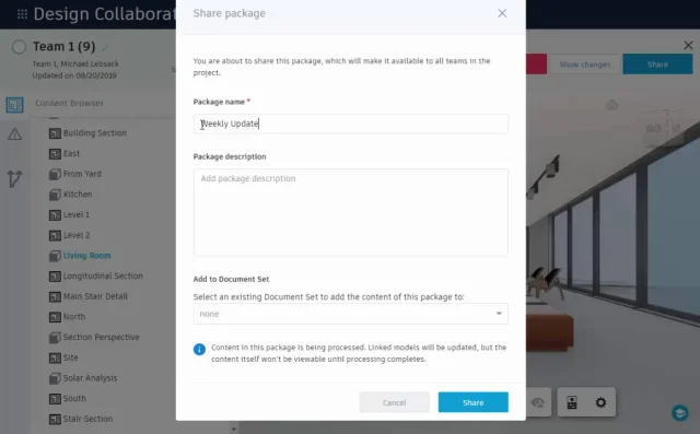

Share a Package
  1. Click the package in progress node on your own team line .
  2. Verify that the appropriate selections have been made.
  3. Optionally, use the drop-down menu to add the package to a Document Management set.
  4. Click Share.
In the package timeline, you’ll see that the package node is now filled out with your team’s color. This package node now appears to other teams on the Shared line so they can inspect and consume it.

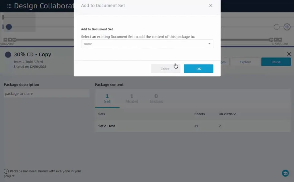

Add a Package to a Set in Document Management
Add packages to document sets to enable downstream workflows such as document reviews or downloads of package content. There are two ways to add your team's packages to a set in Document Management:
When sharing a package:
  1. Use the drop-down menu to add the package to a Document Management set.
  2. Click Share.

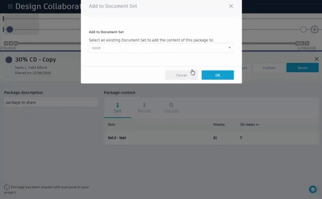

When viewing previously shared packages:
  1. Click a package in your team's timeline.
  2. Click Add to document set.
  3. Choose a set using the drop-down menu.
  4. Click Ok.
