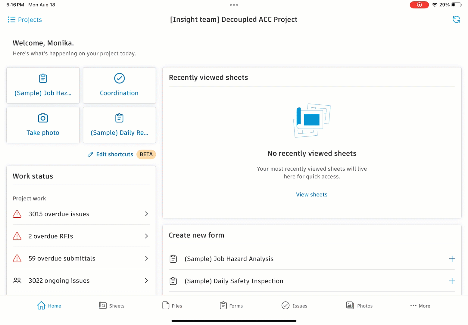

Project Home on the Autodesk Construction Cloud mobile app provides you with an overview of recent changes on your project from your iOS or Android device. Use Project Home to quickly access recent sheets, files, issues, forms, and Shortcuts.
Shortcuts provide fast access to your most-used workflows, allowing you to start tasks such as creating issues, daily logs, or photos with a single tap. By customizing your shortcuts, you can streamline your daily activities and reduce the time spent navigating through menus.
You can also access the Sheets, Files, Forms, and Issues tools at the bottom of Project Home. Tap the More menu to access all other tools.

Shortcuts
Shortcuts lets you quickly start commmon workflows in the Autodesk Construction Cloud mobile app. Use shortcuts to save time and reduce the number of taps needed to create issues, forms, or photos.
Note: Shortcuts are currently available in public beta on mobile devices only. Web support may be added in the future.
Who can use Shortcuts
All field users with the mobile app can use Shortcuts on their iOS or Android devices, including superintendents, project managers, and project engineers, for whom the feature is primarily intended.
What you can do with Shortcuts
  • Start a workflow with one tap from the Project Home screen
  • Add, remove, or reorder up to four shortcuts per project
  • Choose from default shortcuts or create your own.
  • Launch workflows for forms, issues, issue templates, or photos.
  • See only the shortcuts you have permission to use.
Work with Shortcuts
  1. Tap a shortcut on the Project Home screen to launch the selected workflow.
  2. Tap the Plus icon to add a workflow if you have fewer than four.
  3. To manage shortcuts, tap Edit shortcuts.
    • Drag and drop to reorder
    • Tap to delete a shortcut
    • On iOS, tap Save to apply your changes. On Android, changes are saved automatically.
  4. When adding a shortcut, select from:
    • Issues (by type or template)
    • Forms (by template)
    • Photos (take a photo or upload from your library)
      Note: Shortcuts update automatically if you lose access to a workflow or if a template is archived or deleted.
Default shortcuts
Each project starts with up to three default shortcuts.
  • Punchlist issues
  • Daily log form
  • Take a photo
If you do not have permission for a default shortcut, you see an ampty slot. Tap the empty slot to add a new shortcut.
Shortcuts considerations and best practices
  • You can have up to four shortcuts per project
  • Shortcuts are user-specific and project-specific
  • If a shortcut becomes unavailable, it is removed and replaced with an empty slot
  • Shortcuts are available offline after syncing
  • Shortcuts are saved and persist across sessions

Work status
The Work status card is made up of the following parts:
  • Your assigned work:
    • The total number of ongoing and overdue issues assigned to you
    • The total number of ongoing and overdue forms assigned to you
    • The total number of ongoing and overdue submittals assigned to you
    • The total number of ongoing and overdue RFIs assigned to you
  • Project work: The number of total overdue and ongoing issues, RFIs, and submittals on your project.
Tap on either the overdue or the ongoing issues, RFIs, or submittals to be taken to the relevant tool and view the items.
