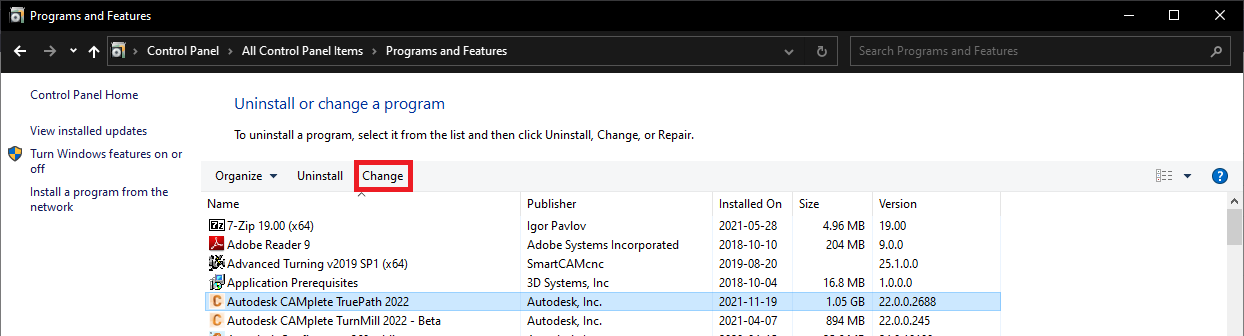

Access the Windows Control Panel via the Windows start menu.
In Control Panel, select Programs and Features.
Select Autodesk CAMplete TruePath.
Click Change.

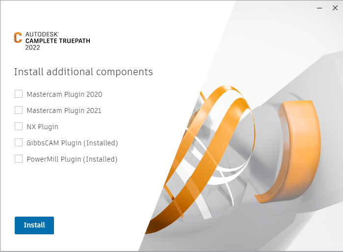

Select the plugin for your CAM system, when prompted.
Click Install.
When the plugin is finished installing, click "Finish" to complete the installation.
