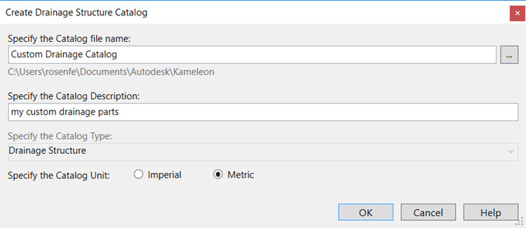

  4. Click Create.
  5. Specify a file name, type, description, and units of measurement, then click OK.
  6. You can now add or modify part families.
