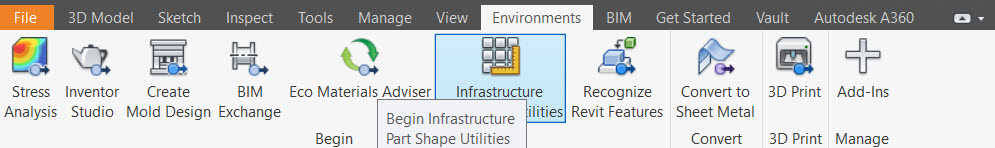

To access the Infrastructure Part Shape Utilities tools
  1. Close Autodesk InfraWorks.
  2. Open Autodesk Inventor.
  3. Click the Environments Tab in the Autodesk Inventor Ribbon.

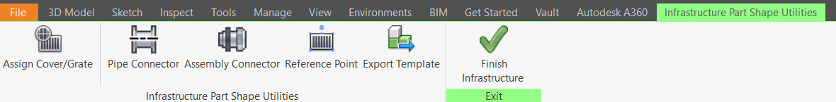

  4. Click Infrastructure Part Shape Utilities.
  5. The Infrastructure Part Shape Utilities tools are now available to use.
