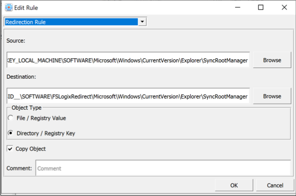

Step 1: Redirect the SyncRootManager Registry Key (Required for Roaming Profiles)
Apply these changes to your gold image:
  1. Install Desktop Connector (any supported version; 16.9.1.2222+ is required if the workspace location is changed).
  2. Redirect the SyncRootManager registry key:
    • Use your vendor's method to redirect the following registry key from HKLM to HKCU.
    • Change the registry path from: HKEY_LOCAL_MACHINE\SOFTWARE\Microsoft\Windows\CurrentVersion\Explorer\SyncRootManager to a location under HKEY_CURRENT_USER with your redirection tool.
    • For example, with FSLogix, use FSLogixAppsRuleEditorSetup.exe to redirect:
      • Source: HKEY_LOCAL_MACHINE\SOFTWARE\Microsoft\Windows\CurrentVersion\Explorer\SyncRootManager
      • Destination: HKU\__USER_SID__\SOFTWARE\FSLogixRedirect\Microsoft\Windows\CurrentVersion\Explorer\SyncRootManager
      Registry Redirection

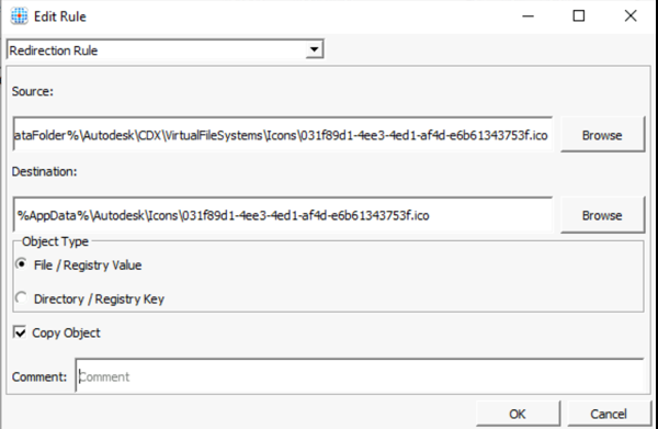

Step 2: Move the Forma Connector Icon File (Optional)
If the Forma Connector icon does not appear in Windows File Explorer:
  1. Move the icon file to the user profile:
    • Source: C:\ProgramData\Autodesk\CDX\VirtualFileSystems\Icons\031f89d1-4ee3-4ed1-af4d-e6b61343753f.ico
    • Target: A location under the user profile folder, preferably %appdata%\Autodesk\CDX
    • For example, with FSLogix, use FSLogixAppsRuleEditorSetup.exe to create the following file redirection rule:
      • Destination: %AppData%\Autodesk\Icons\031f89d1-4ee3-4ed1-af4d-e6b61343753f.ico
      Icon Redirection

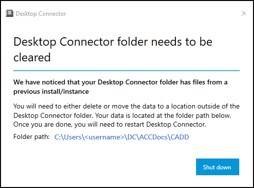

What if I skip these steps?
If you do not complete the required configuration, you may experience the following issues:
  • Changes made on your local device will not be recognized by Desktop Connector and will not sync to Forma.
  • Each time the virtual machine is started, Desktop Connector will show the "Desktop Connector Folder Needs to be Cleared" dialog. Users must clear the local workspace and restart Desktop Connector.
    Clear Connector
