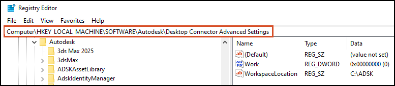

Important: Administrators should note that setting the WorkspaceLocation value at the HKLM (HKEY_LOCAL_MACHINE) level will affect all users of the machine.
The Registry key (HKLM) can be found at Computer\HKEY_LOCAL_MACHINE\SOFTWARE\Autodesk\Desktop Connector Advanced Settings > WorkspaceLocation = C:\ADSK
Change Workspace HKLM

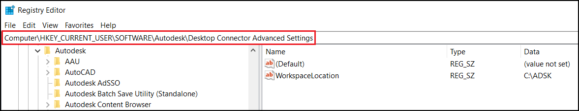

To apply only to the current user, you can set the registry key (HKCU) at Computer\HKEY_CURRENT_USER\SOFTWARE\Autodesk\Desktop Connector Advanced Settings > WorkspaceLocation = C:\ADSK
Change Workspace HKLU

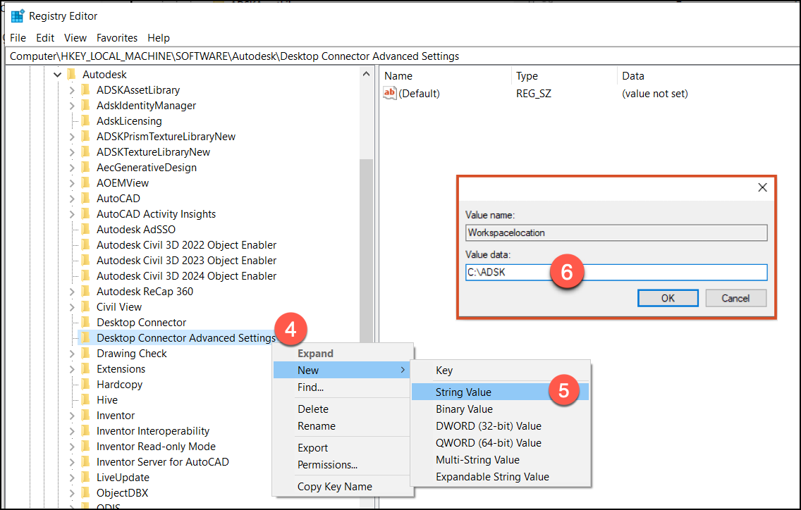

Administrators will need to set the WorkspaceLocation as a string that specifies the location for the NEW workspace. This modification can be made at either the HKLM or HKCU level in the registry. The HKLM level will apply the modifications to all users of the machine, while the HKCU level only applies to the current user.

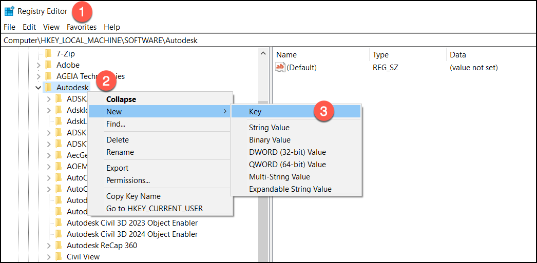

  1. In the search box on the taskbar, type regedit, then select Registry Editor
  2. Navigate to location: Computer\HKEY_LOCAL_MACHINE\SOFTWARE\Autodesk
  3. Right click Autodesk and Select New > Key
    Create the key
  4. Create Desktop Connector Advanced Settings Key
  5. Create a string value Workspacelocation
  6. Set the value of WorkspaceLocation = C:\ADSK (this folder is used as an example only)
    DC-workspace-stringvalue
  7. Restart Desktop Connector Desktop Connector Tray Icon
  8. After Restarting Desktop Connector you will have a new workspace location.

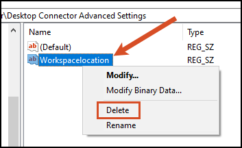

When there is a workspace change uninstalling does not eliminate the registry key associated with the admin workspace changes. To return the Desktop Connector to a state resembling a fresh installation, and to restore the default workspace, administrators must manually delete this registry key.
As an administrator, using the Reset Utility and Uninstall Desktop Connector will not reset the workspace location if it has been previously set by you or an individual user. If there is a need to reset a user's workspace, follow these steps to resolve:
  1. Shut Down Desktop Connector
  2. Backup your registry
  3. Navigate to the registry key Computer\HKEY_LOCAL_MACHINE\SOFTWARE\Autodesk\Desktop Connector Advanced Settings or Computer\HKEY_CURRENT_USER\SOFTWARE\Autodesk\Desktop Connector Advanced Settings
  4. Delete WorkspaceLocation
    Change Workspace DeleteKey
  5. Navigate to C:\Program Files\Autodesk\Desktop Connector\Reset\ResetDesktopConnector.exe and run ResetDesktopConnector.exe
    Reset Workspace
  6. Restart Desktop Connector Desktop Connector Tray Icon
After you restart Desktop Connector your workspace will be located at the default location C:\%userprofile%\DC

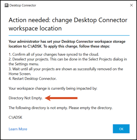

Admin deploys to Directory that is not Empty
The Desktop Connector workspace location chosen by your admin is not empty and needs to be cleared.
  • You will need to empty your folder and clear your workspace before the admin imposed workspace being used.

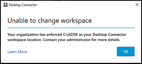

User attempts to initiate a change workspace after Admin Change
The admin has mandated a standard that requires the Desktop Connector workspace to be in a predetermined location.
  • If you attempt to alter the workspace location, you will receive an error message.
  • This message is to notify you that a change has been enforced by your organization.
    Unable to Change Workspace

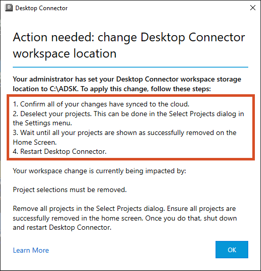

If the admin imposes a new workspace location for current Desktop Connector users, they are bound to encounter one of two messages.

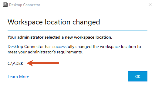

  1. If there were no project selections impeding their migration users would be greeted with a success dialog, notifying them of their updated workspace location.
    DC Location Changed ADSK

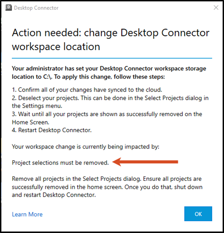

  2. if a user has ongoing project selections or queued jobs, they will be presented with a specific dialog featuring instructions on how to successfully modify their workspace.
    DC Location Changed

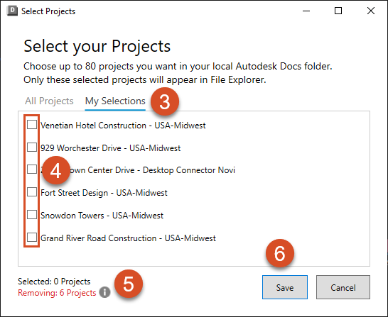

User receives Action Needed about existing Project Selections
Important: Verity that you do not have any unsynced changes before unselecting your projects.
  • Follow these steps to remove your projects.
    Change Workspace Action Needed

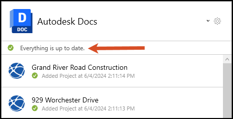

  1. Check the Home Screen to see if there are any pending actions and if everything is up to date.
    DC Up to Date
  2. Right-click on the Desktop Connector tray icon and Select Projects.
    DC Select Projects
  3. Move to the My Selections tab
  4. Deselect all the projects within this tab
  5. You will receive notification that projects are being removed from the workspace
  6. Select Save
    Unselect workspace projects
  7. Check that all your projects are successfully removed in the Home Screen.
When you restart Desktop Connector with your new workspace, you will be prompted to select projects you wish to be shown in your local Autodesk Docs connector.
