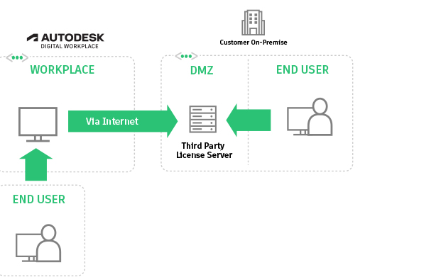

Option 3: DMZ License Server
DMZ License Server
Overview:
In this option, Digital Workplace desktops will be configured to access third-party license servers using a public IP address provided by the customer. The license servers will reside in a publicly accessible secure area accessible from the internet, such as a DMZ.
Implementation:
Customers will host third-party license servers in their DMZ environment or a publicly accessible secure area on the internet as mentioned above. The customer will then set up firewall policies to ensure access to these license servers is only allowed from public IP addresses used by Digital Workplace desktops, which will be provided by Digital Workplace engineers.
The customer will be responsible for providing the public IP addresses for these license servers to Digital Workplace engineers. The customer’s Digital Workplace desktops will be set up to use these public IP addresses when accessing the license servers.
Data Flow:
Digital desktop -> Workplace VNet -> Azure outbound load balancer -> internet -> Third-party license servers
Requirements for this option:
  • Collaboration between the customer’s IT engineers and Digital Workplace engineers.
  • Third-party license servers with applications pre-installed and configured with licenses.
  • Public IP address established for the third-party license servers.
  • Firewall policies in place to ensure access to license servers is only allowed from public IP addresses used by Digital Workplace desktops (IP addresses will be provided by Digital Workplace engineers).
  • Customer-provided Digital Workplace desktops set up to use dedicated public IP address when accessing the internet.
