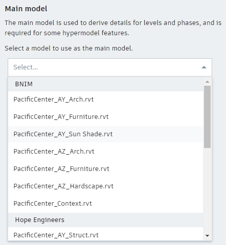

Select a Main Model
The main model is used to derive details for levels and phases in the project. It is also used for certain hypermodel features.
If no main model is selected, the largest published model is used.
To select the main model:
  1. Use the Module selector to switch to Project Admin.
  2. Under Services, click Design Collaboration in the left panel.
    Note: If you enter the Project Admin module directly from Design Collaboration, you start in this position.
  3. Click the Manage tab.
  4. Select the model you want to use as the main model from the drop-down list.
The list of models is populated from the Shared folder.
