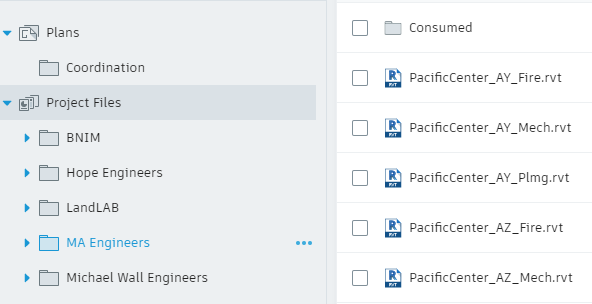

Tip: When adding a link in Revit as a team that has consumed a shared model, navigate to your team's Consumed folder in Document Management (Project Name/Project Files/Your Team Name/Consumed/Team Name/FileName.rvt).

Tip: When adding a link in Revit, navigate to the sharing team's Shared folder in Document Management (Project Name/Project Files/Shared/Team Name/FileName.rvt).

Tip: When adding a link in Revit, navigate to the sharing team's live model in Document Management (Project Name/Project Files/Team Name/FileName.rvt).
