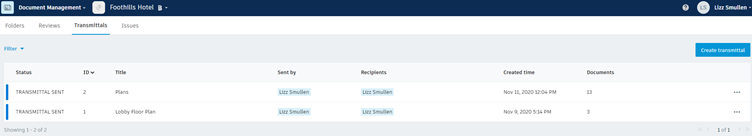

View and Download Transmittals
After a transmittal is created, it is visible on the Transmittals tab in Document Management. From here, you can:
  • View the transmittals.
  • View the documents contained within each transmittal.
  • View the sender and recipient(s) of the transmittal, based on permissions.
    • The sender and project administrators can view all recipients.
    • Non-admin recipients can view other recipients if the sender has granted those permissions. The sender and project administrators can adjust this setting from the More menu .
  • Download the documents contained in the transmittal.
To do so:
  1. In Document Management, switch to the Transmittals tab.
  2. Click a column header to sort the list of transmittals, or use the Filter drop-down list to filter the list by initiator or creation date.
  3. Click a transmittal from the list to open the transmittal details.
Note: All transmittal added documents will have the following attributes: Name, description, path, version, last updated, updated by.
  1. If necessary, click a document to open it in the viewer.
  2. Review the details of the transmittal for the sender and recipient(s) in the right panel. Details include:
    • Time and date the transmittal was sent and received
    • Parent folder for the documents contained in the transmittal
    • Any message in the transmittal from the sender
  3. If required, click Download ZIP files to download a local copy of all documents in the transmittal.
    Note: You can download transmittal packages up to a maximum size of 30GB and 4,000 documents. Contact customer support for assistance downloading additional documents from one transmittal.
