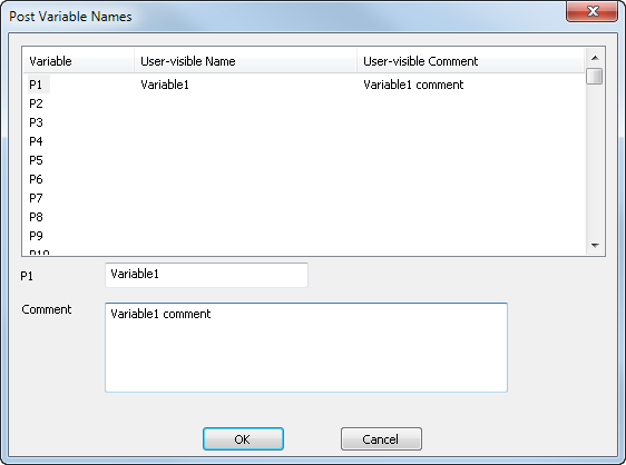

Post Variable Names dialog
You can use the Post Variable Names dialog to rename post variables to make them easier to use.
You can insert a variable into a Format using the <P1> to <P100> reserved words, or by using the <PVAR:User-visible Name> reserved word.
You can specify what the variables resolve to in the NC code by using the Post Variables dialog in the FeatureCAM document, either at the document level or for each operation.
You can specify a User-visible Comment that is displayed in the HTML documentation:
Operation-level example
