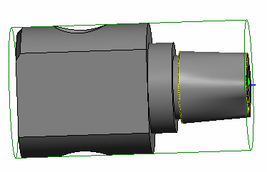

Use this menu option to display the block limits for Advanced Surface Machining on a solid model.
When Show Block Limits is selected, PartMaker displays the block limits on the solid model. For example:
