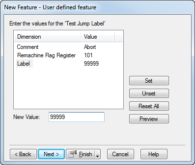

  6. Create an Abort label at the end of the NC code:
  7. Set its Base priority to a large number, such as 100.
    The NC code for this Test Jump Label feature reads:
    ( Test Jump Label PROBEOPER TEST_JUMP_LABEL3 )
    (Abort)
    #101=0
    N99999
