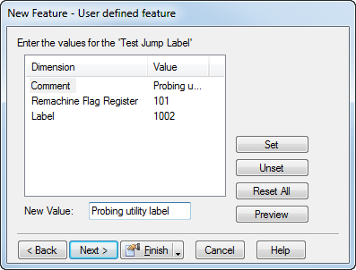

Test Jump Label
Comment — The comment is output in the NC code at the start of the test feature.
Remachine Flag Register — This is the register where the machine stores the count for the number of times the feature is remachined.
Note: The Test Jump Label feature has the same functionality as the Remachine Jump feature, which has been left in to maintain compatibility for user files. We recommend that you use Test Jump Label in preference to Remachine Jump.
